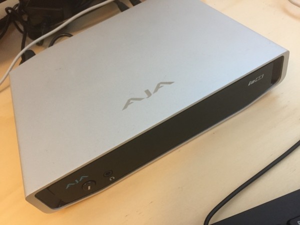

I like this device more and more. It captures even BIOS and windows boot screen. So you can use you laptop as a monitor
