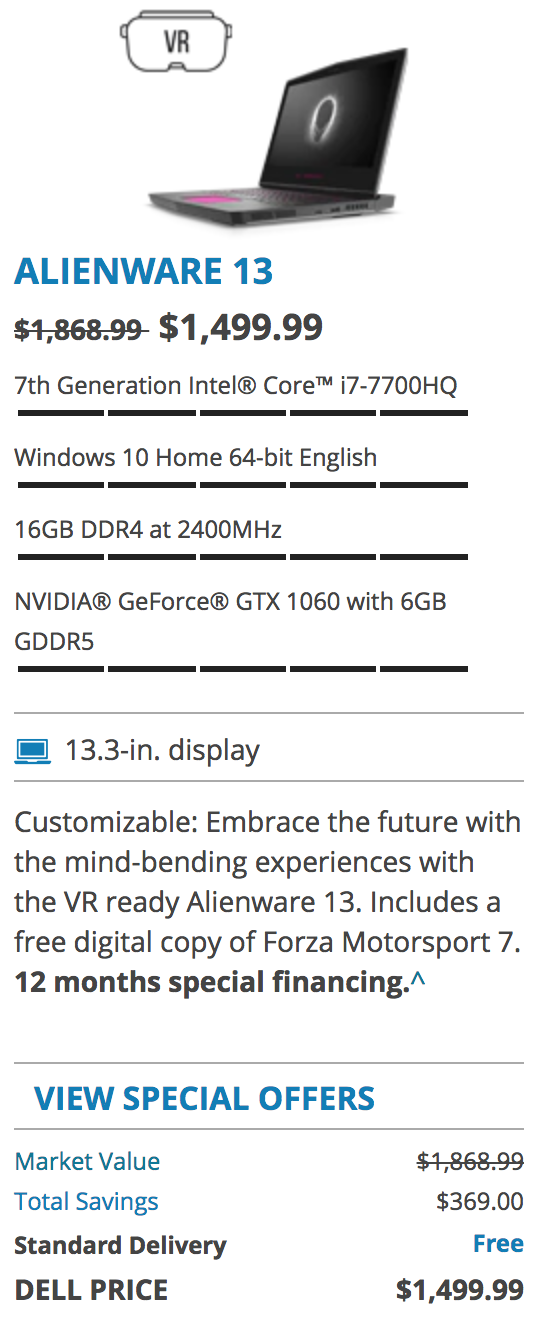

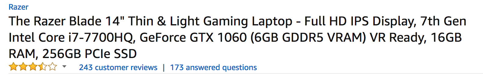

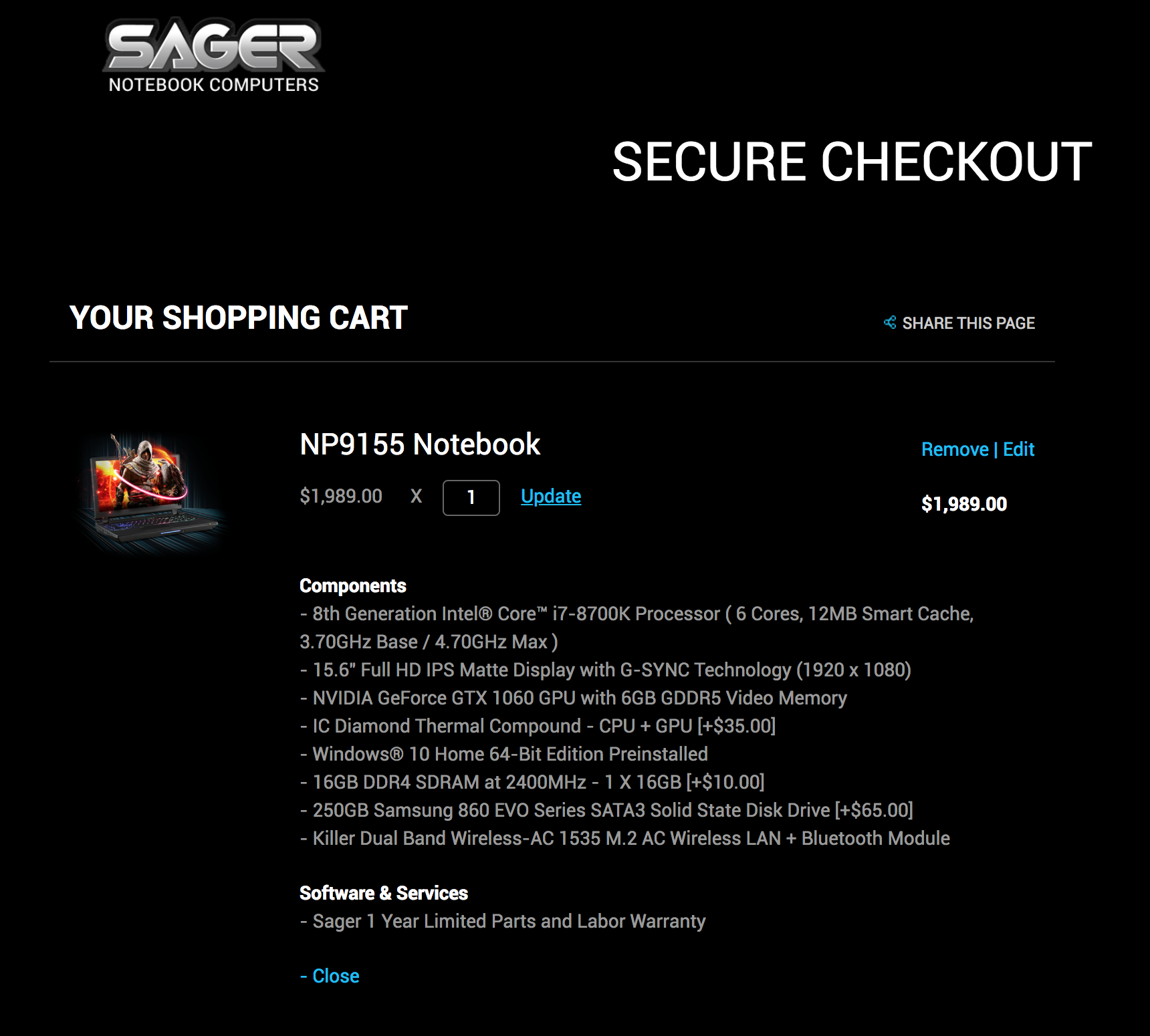

I'm looking at the ones I've attached, what do you think (i'll only be running 3/4 layers max) ?
I still see a half second black screen when jumping form a clip to another. Will this disappeared with better computer performance or is this the way Resolume is built?
