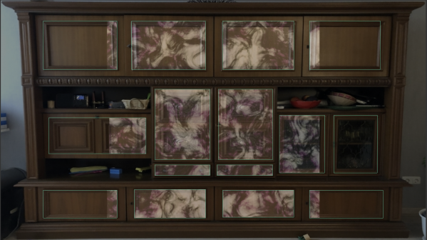

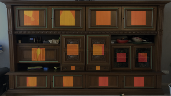

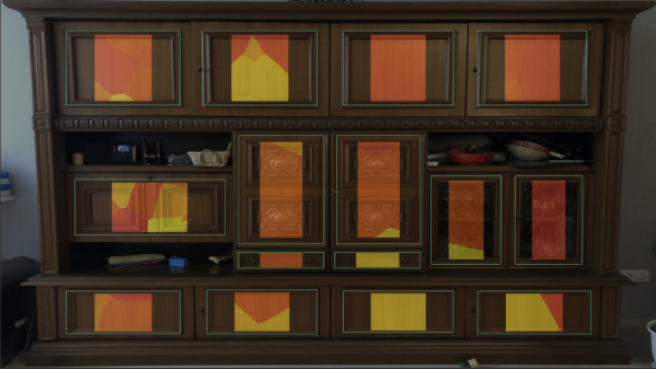

I'm trying to do some blinky slices with Slice Transform.
When I apply the blink sequence (slice a, than slice b+c, than all, ..) direct to the clips, lets say 8 clips for an 8 step sequence, it works fine for me.
But when Im trying to split content and blink position for more flexibility I have an issue.
My idea was to combine my content from layer 1 with a mask layer above using slice transform in that layer, but I get a cropped result when using the mask scaling option.
Also with the other slice transform scaling options its seems wrong what I get, see below. Beside the wrong size its more like a cropped mask option shows the content behind, than a repetition of the same content in any slice as usual.
If I just use the effect layer (with deactivated mask option) the video is not cropped I get an overlay of layer 1 and 2. If 1 is dark, there is nothing the effect can use. hmm
Thanks a lot for your help <3

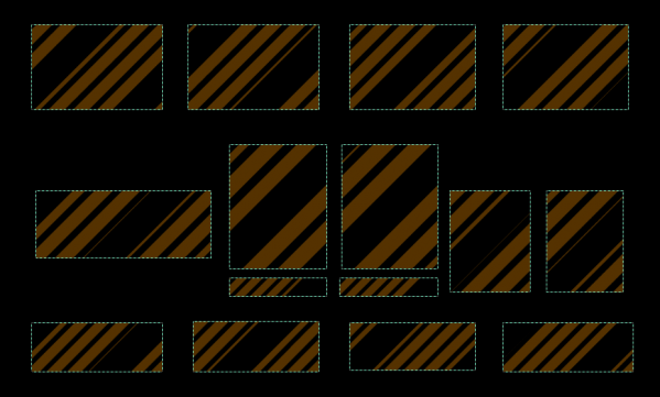

I've found one more thing while playing with the "slice test". see below
slice test with lines.avc
(48.99 KiB) Downloaded 545 times
when using a line source in layer1 and flipping some tiles in the mask layer slice transform it is visible that the &quot;slice test&quot; file is an overlay of 2 x lines with different directions. in this example the top layer is using fill scaling and the bacground picture using mask scaling
when using a line source in layer1 and flipping some tiles in the mask layer slice transform it is visible that the "slice test" file is an overlay of 2 x lines with different directions. in this example the top layer is using fill scaling and the bacground picture using mask scaling
