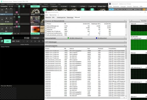

I open Resolumen and Live (I think it doesn't matter which is opened first), enable the "Link" button on both and see that it doesn't work. There should be a "1" in the Ableton Live link button, but Resolume is not linked. The tempo doesn't match, Live hat 82 bpm while Resolume has 73 bpm.
In the network monitor I see that Resolume and Live use the 20808 port alternately, not at the same time. But it is not the IPv4 loopback, it says "Ipv4 not indicated/specified" or something like that ("IPv4 nicht angeben" in German).

That's strange.
Even when I enable windows firewall and clear all existing rules for both Arena and Ableton, and don't allow them to communicate, the are able to Link up on localhost.
Could you try again after disconnecting wired and wireless networks from the machine?
Re: Ableton Link with Resolume on the same computer
Disconnecting the WLAN network (I have no wired network) doesn't make a difference, link still doesn't work. ok, I could send the bpm information with the singlenotegrabber plugin, but link would be so much easier!
