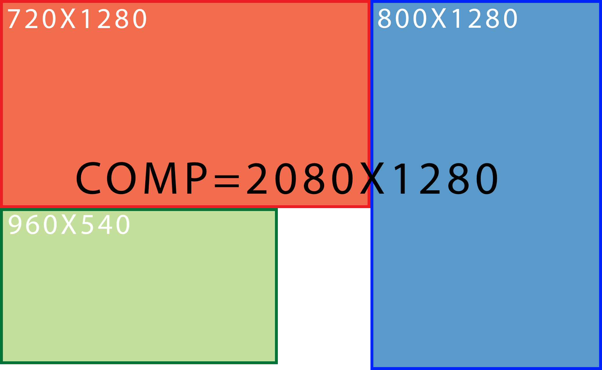

Re: 3 outputs with different sizes
He2neg wrote:I would suggest you use the highest resolution of your three outputs.
Or you can create a composition that is combination of the three outputs and use Slice Transform with the slices that correspond to your various displays to position your content on the final output. Here is an quick example:

Oaktown wrote: Tue Jan 01, 2019 21:56
Or you can create a composition that is combination of the three outputs and use Slice Transform with the slices that correspond to your various displays to position your content on the final output. Here is an quick example:2080x1280.png
Thanks dear for your reply,
With your method, i have to assign each display to one layer
Example :
The red display will use layer 1 only
The blue will use layer 2only...etc
Am i right?
moha20106 wrote:With your method, i have to assign each display to one layer
Example :
Am i right?
You can use layers but I personally use groups for my various screens.

Post by moha20106 »
Oaktown wrote: Wed Jan 02, 2019 21:02
Example :
Am i right?
What the purpose for using Groups, than using my method?
Now I'm trying to add groups, but no different ,
Can you please explain for me, I'm still new with Arena
