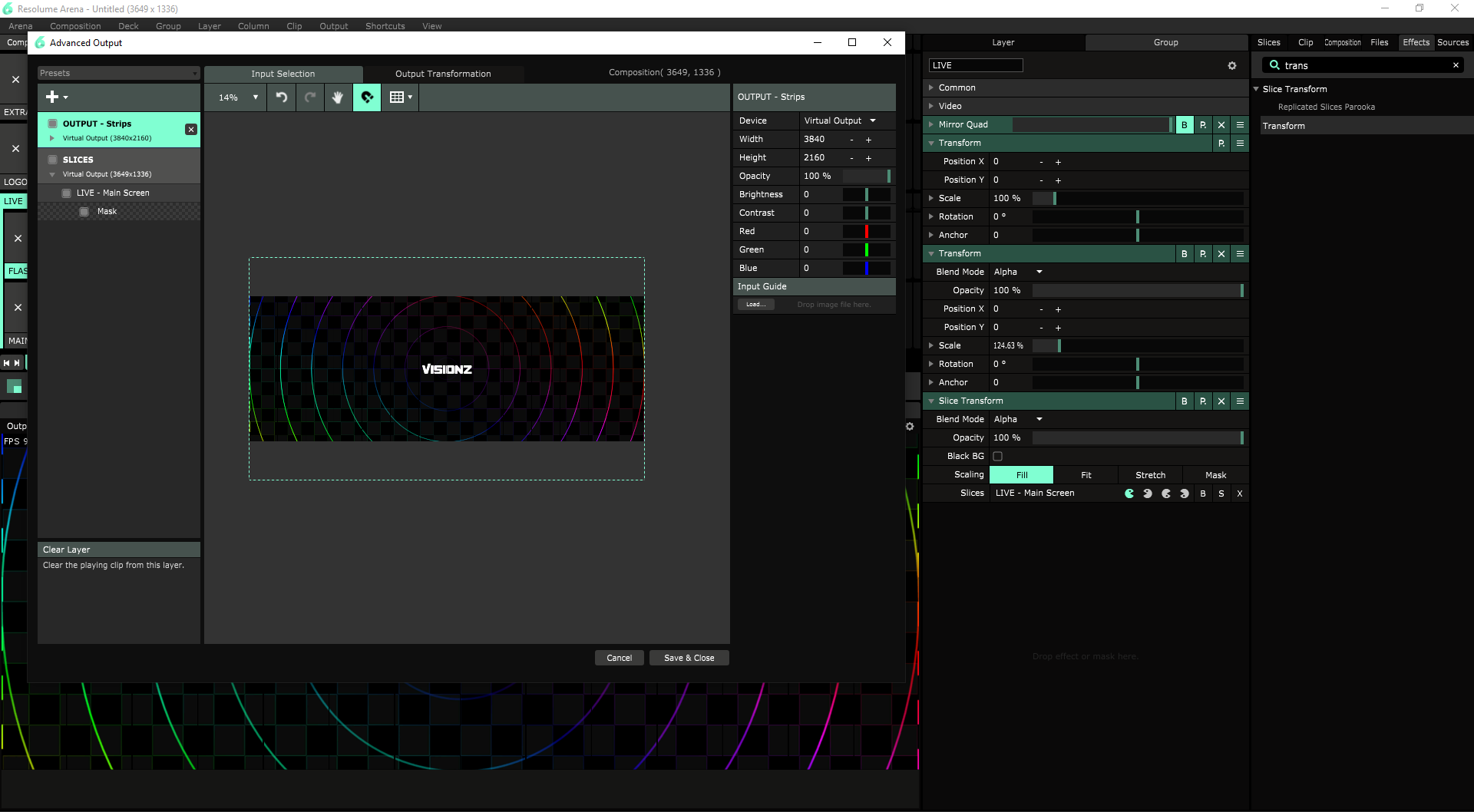

I'm very confused about the way the main transform is working. I will try to make it easy.

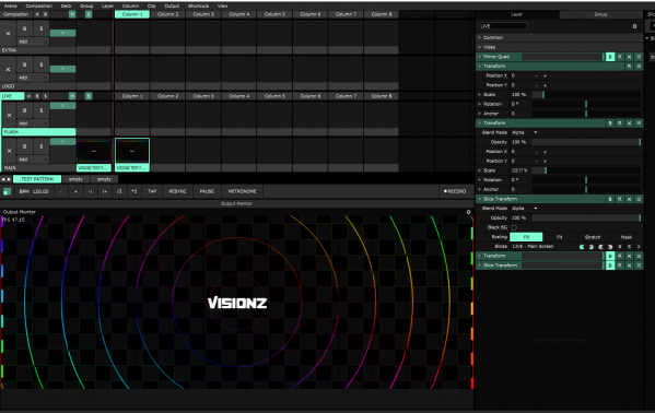

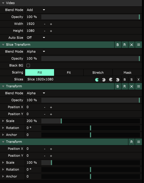

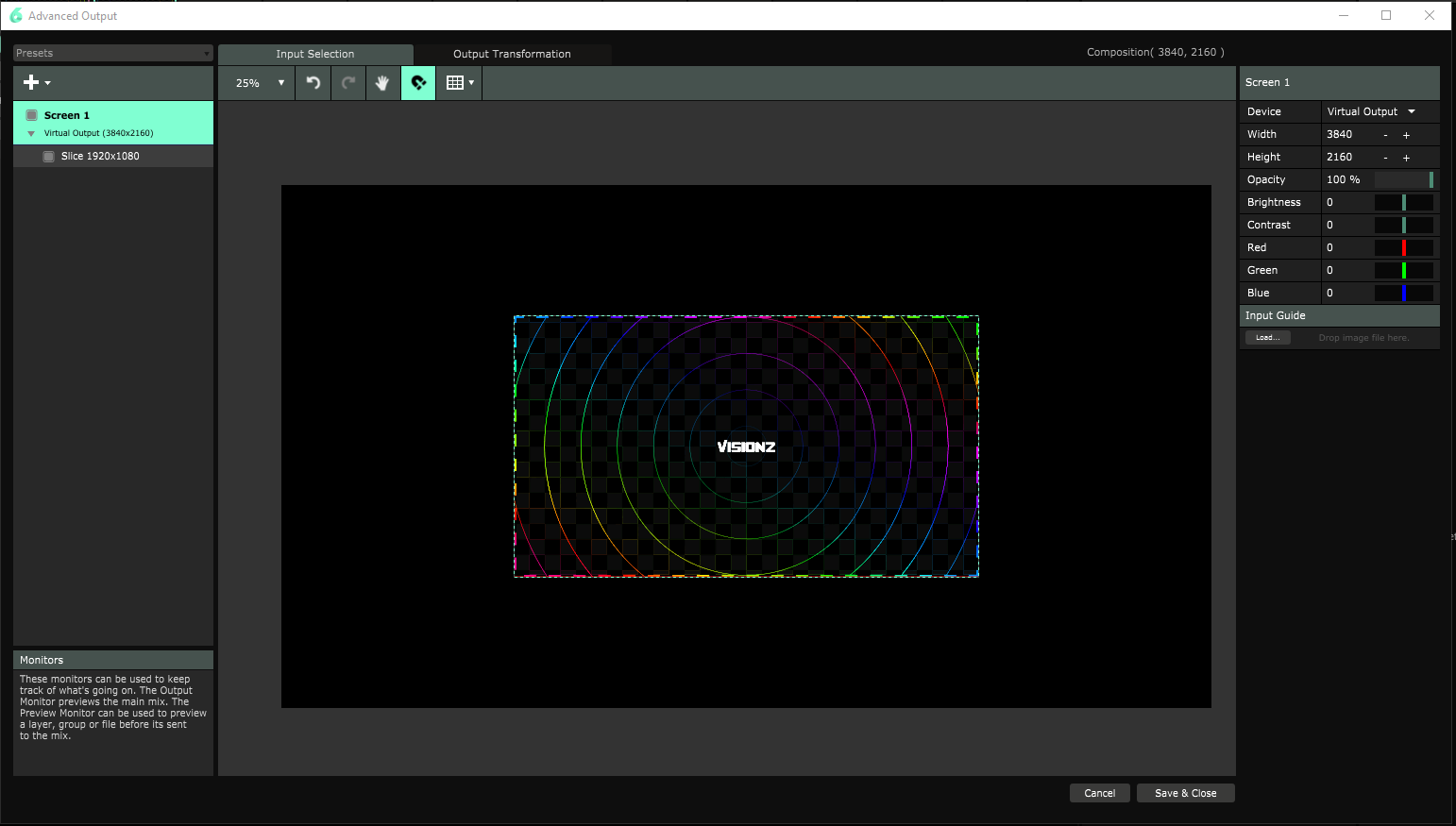

SETUP 1 :
So I'm running a 3840x2160 comp with one layer.
Layer size is 1920x1080 and play a 1920x1080 video.
On the advanced output I have one Output at 3840x2160 and one slice at 1920x1080 perfectly centered (so exact video and layer size).
They way I understand it, If I apply a slice transform that has the exact same size and position nothing should move.
BUT then comes that fixed transform effect that rescales everything to the comp size and so makes my video 2 times smaller.
If I want to bring it back to real size I have to add an other Transform and scale it up at 200%.
That works, but I'm gettin confused, why do I need 2 times a transform that does work the same way and on is just doing the opposit of the second one.
Transform x Slice Transform x Transform

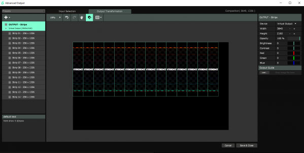

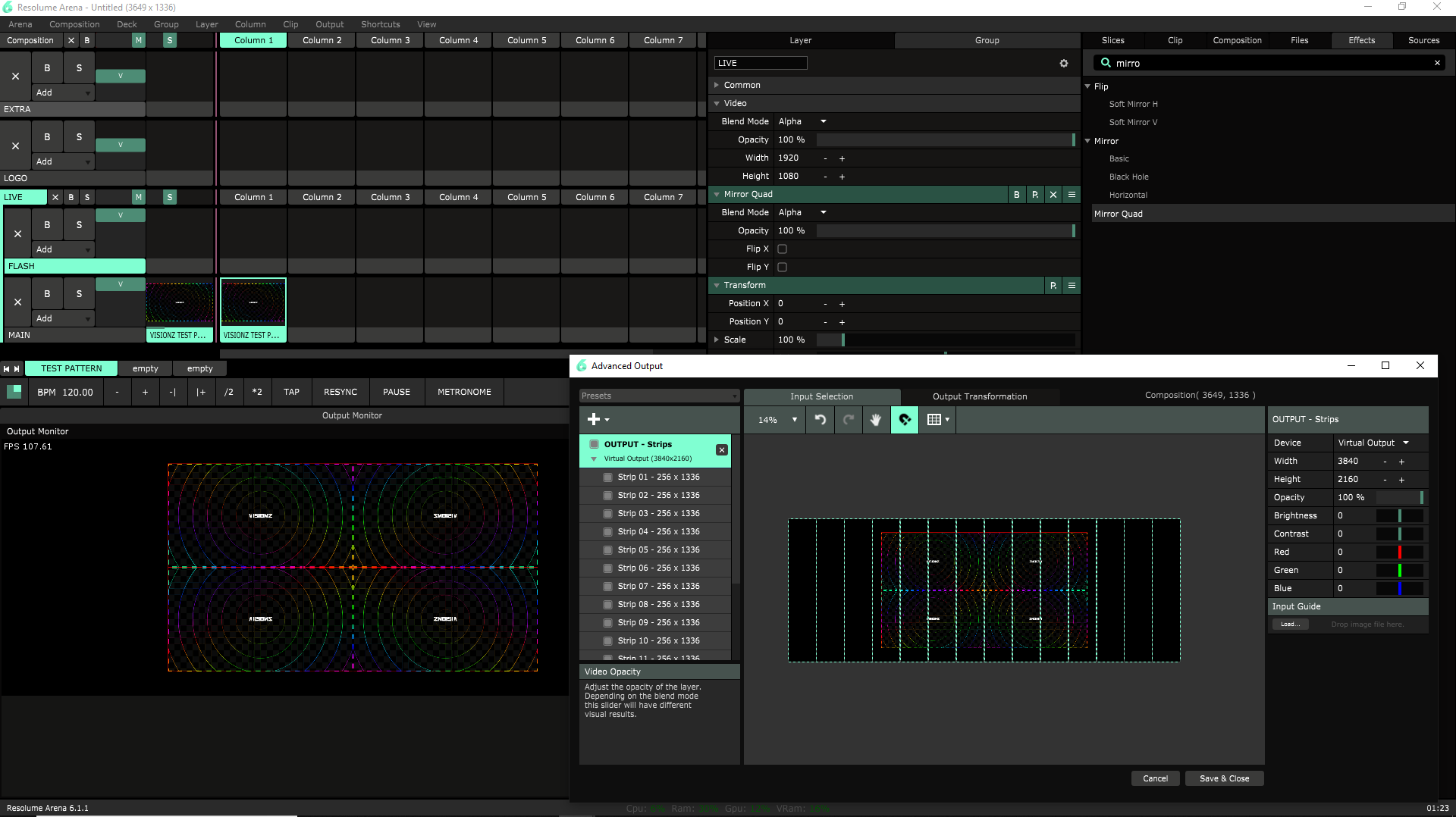

SETUP 2 :
Let's go on something more funny, 14 strips 256x1336
I do my inputmap with a 5px gap between each for a 3649x1336 composition size.
This tim I will use a Group with some layers to play with my 1920x1080 content. And Add extra layers over it that should not be affected by any effects.
This way all my effects are not cropped and I can use the full potential of my 1920x1080 loops to play live.
Now the only way to rescale that is to apply a Slice transform + transform for each rescale scenario.
BUT as the main transform alway brings it back to the comp size, it's never matching my 16/9 slice perfectly.
Is there any way to make that fit perfectly in the slice so that I can control all my upscale pixel perfect with slices in the advanced output, instead of playing with non precise size sliders.

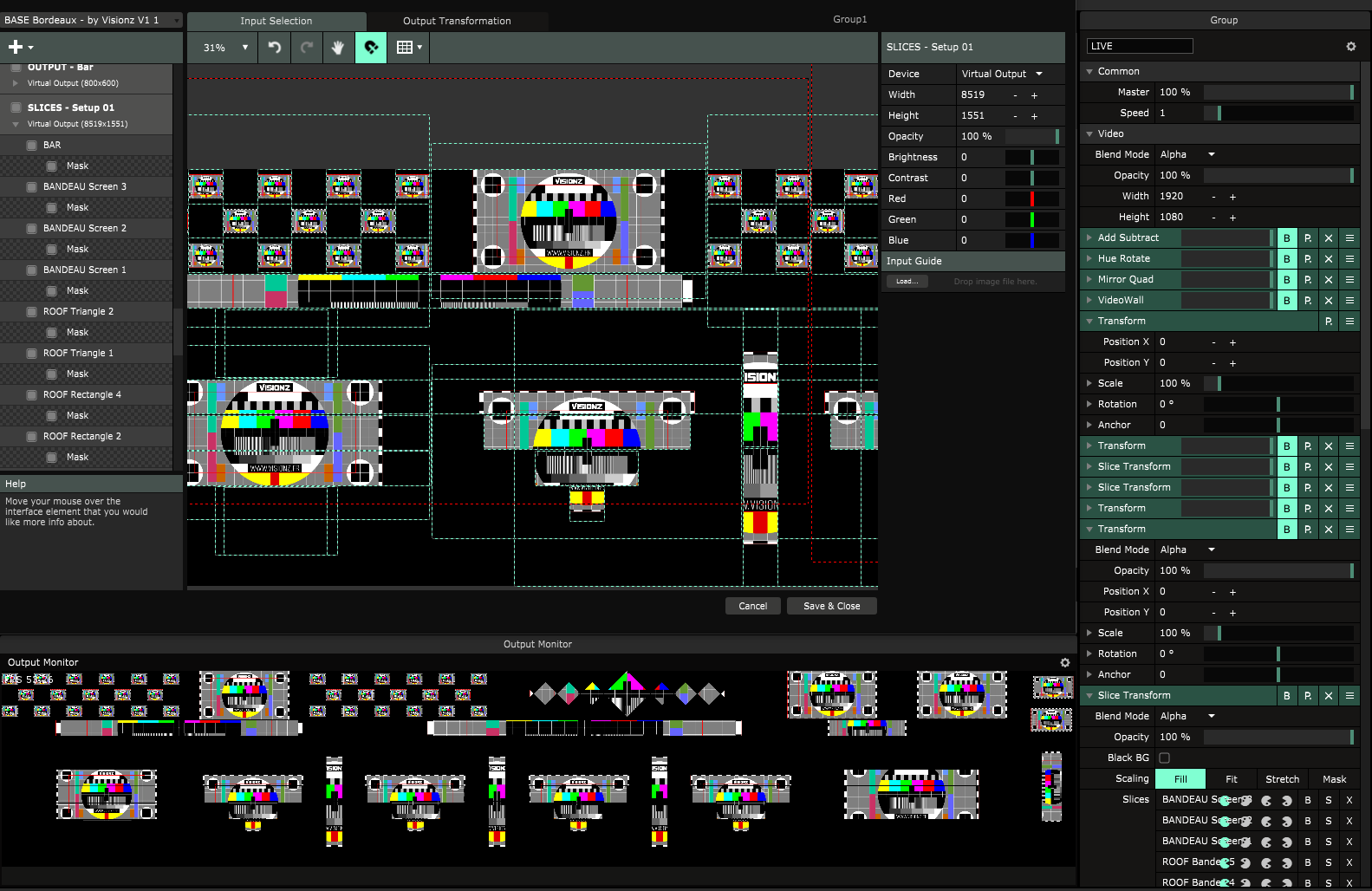

It's a bit hard, as I'm looking for a method that works on every type of stage.
But ok let's take a club setup I did last month :
Composition size is 8519x1551, with a lot of stufff going on. Upper stuff is on the wall and lower stuff in on the roof.
If I apply a regular slice setup without any transform upscale it slice transform to my comp size.
If I do all my slices at 16/9 Ratio (like my content) and mask out the screens it looks like I have better result, But I still transform the comp size and need to upscaled my content to make it fit.
So what ever the setup is, I'm still in the first config situation where I have a useless Downscale / Upscale to do.

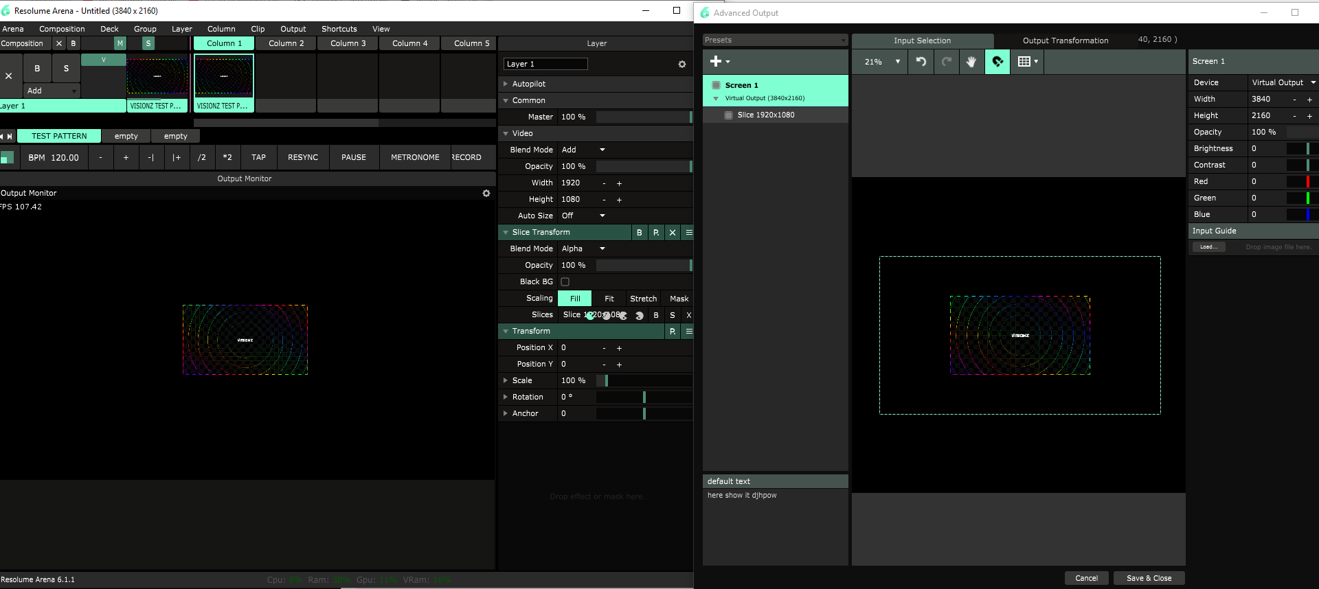

Okay, without a practical example I can't show you how to do it. So I'll try to explain how it works.
Think of it like a kids' coloring picture. Slice Transforms are the black and white outlines of the shapes that make up your picture. They prevent you from coloring outside of the lines. But you still have to decide how to fill them.
So you're going to need to do some scaling yourself. Every stage is different, every look is different. So you need to eyeball how to scale your content on the stage. Depending on your content, a stage with very wide wings needs a different scaling than a stage with lots of thin vertical pillars. There is no way to automate this. In fact, deciding which looks work on a particular stage is what sets a good VJ apart from a technician.
If you really, really want to automate this, you can use the Auto Size mode on the layer, set to Fill. Combined with Slice Transforms set to Fill, this will make sure your content will always fill the slices you're using it on. If your content is mostly just abstract moving wallpaper, you can get away with this. If you're trying to tell any type of story, you need to make sure your story is visible. I would always use my programming slot to go through my content and my looks, and see if they translate/transform well to the particular stage I'm playing that night.
Practically, I would use the single default transform on the clip to adjust each clip to taste. Using Slice Transforms on the layer, I would then decide which parts of my stage that bit of content ends up. I'd throw out the second transform you're applying everywhere. It doesn't do anything the first one couldn't also do, and just adds confusion.

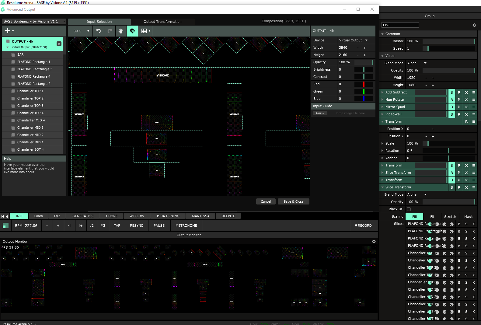

Re: Transform x Slice Transform x Transform
I have had some time today to really dig into this.
I have discovered that I have to have the layer the same size as the composition for this to work correctly.
WHY?
My comp is 5000x2290
I have about 50 different slices that are for all different screens plus a few helper/cheat slices to combine separate screens into one bigger screen.
If i have the layer at the size of the content size 1920x1080 or what ever it would be, which is the most efficient so it is not rendering out a bunch of black pixels I can't get the slice transform to fill the screen unless I zoom the layer 215%
But if I put the layer at the same size as the composition then I don't have to zoom and I don't need to do much of the fit and fill as most of the screens are smaller then the clips I will be playing.
This seems like this is wrong. Why does the layer size need to be the same as the composition size? Why doesn't slice transform take what ever clip on what ever sized layer and apply to the slice and fit/fill/stretch for what is selected.
This seems like a major fopah and causes a lot of wasted rendering of the graphics card/processor/ram/finite computer resources with having to render a 5000x2290 image to fill a 1920x1080 or smaller output slice.
