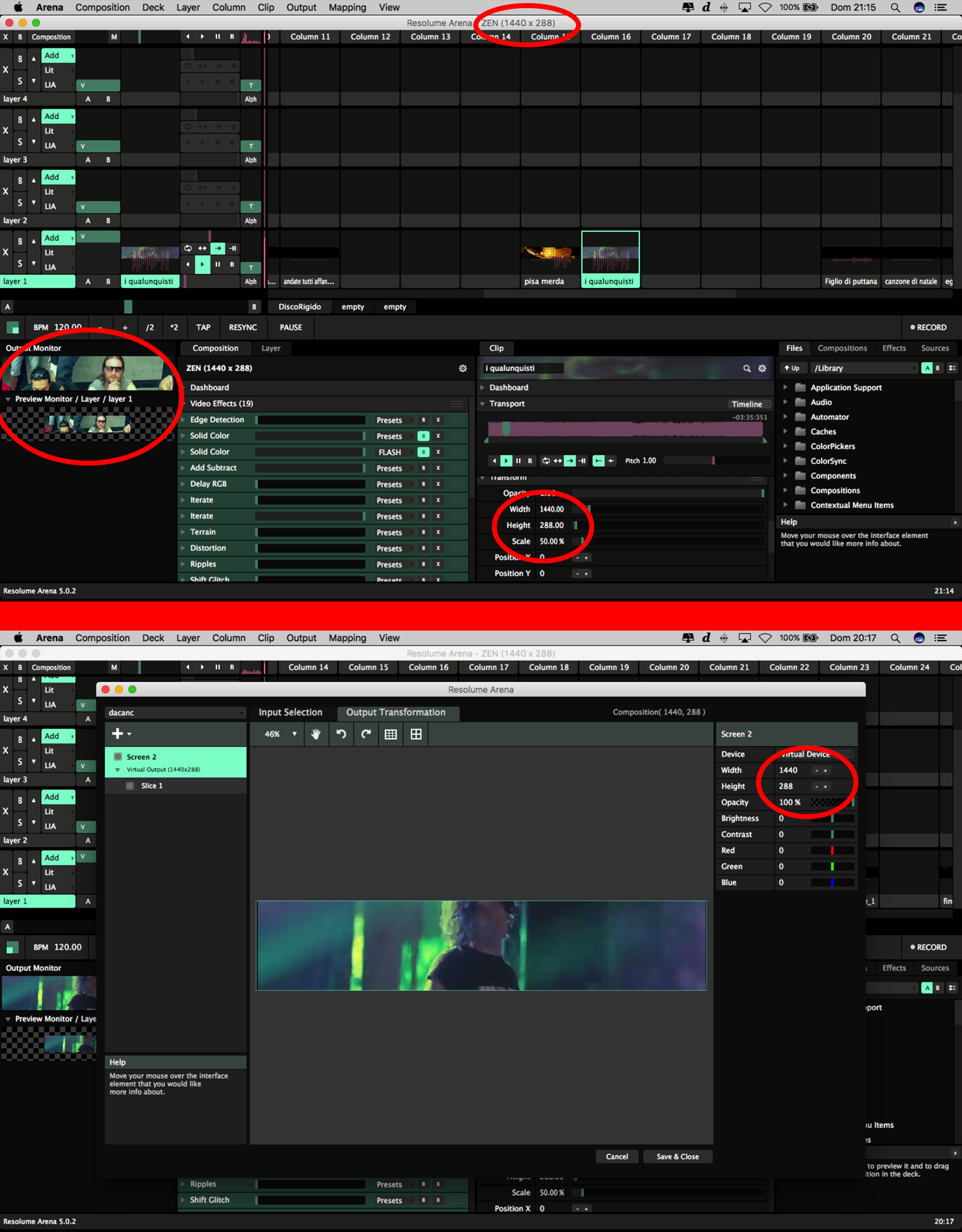

Hi! I'm having a strange problem. For a ledwall with a resolution of 1440x288 I have made a series of clip having this resolution and create a composition in Arena of 1440x288 px.
Why all the clips are bigger than the output?
To play videos at the right size, I'm forced to put scale 50%, with a loss of resolution... HELP
PS in the input option of the advanced output i have selected all the area of the video, not only the centre. And this problem occour even with standard output or virtual device...

Is there an effect on the whole composition or the composition scale that is scaling everything up by 200%?
To me from the screenshots it looks like this is happening:
Clip (scaled down 50%) -> Layer (normal) -> composition (everything scaled up 200%) -> Advanced Output (normal)
eg:
eg:

I finally found out the problem. There was the kaleidoscope effect (one of the 19 effects of this composition) with zoom 0.50. I was loosing my mind
