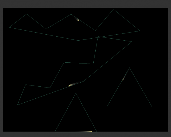

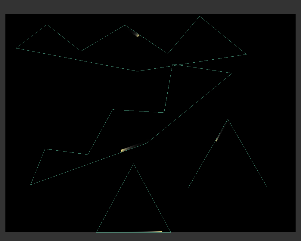

He2neg wrote: Tue Jul 09, 2019 20:48 you can get a edge on every form of slice with that also a pulse is pssible... what i didnt get is a "moving" line following the boarder of the slice ;)
Drop a Radar effect, and an edge detect into the mix at the right places ;)
He2neg
Posts: 951
Location: Berlin, Germany
Re: Edge fade on an irregular slice, how to?
Post by He2neg »
Yes ;) but as a radar is a circle you will get different speeds when following the shape
I know we can get very close but its not perfect still....
~Berlin~
