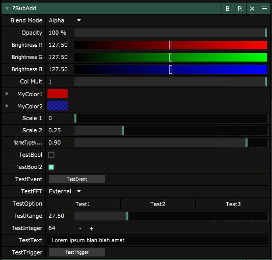

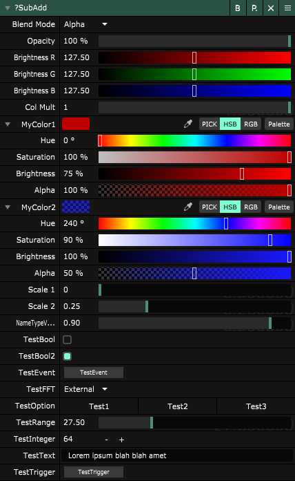

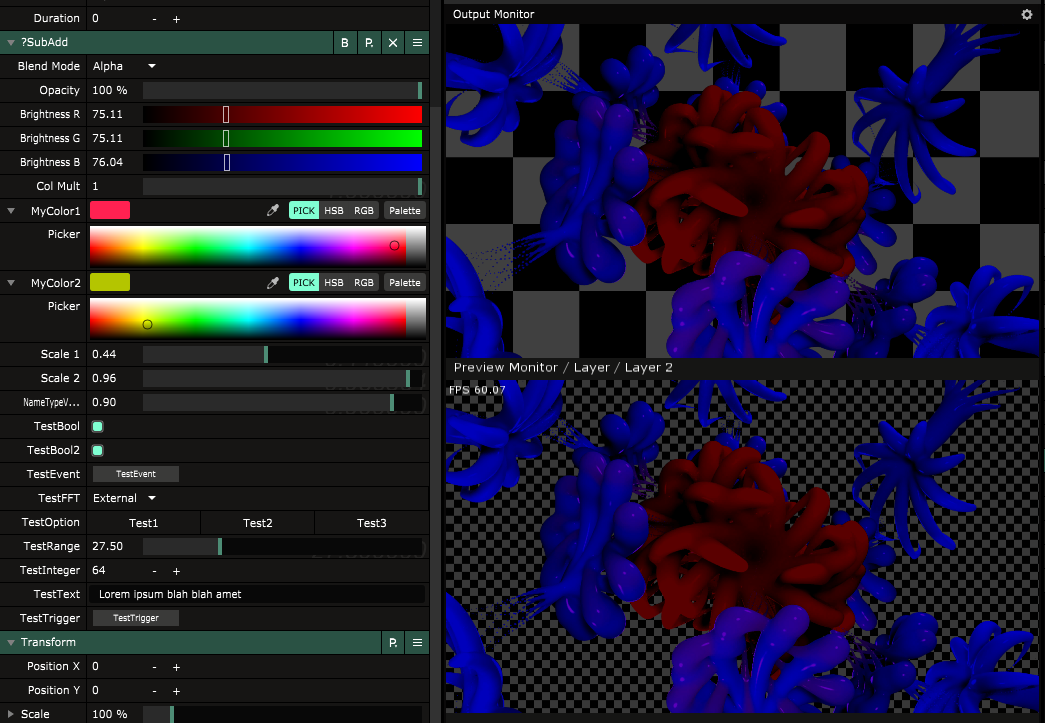

After some concerted effort, I have completely replaced the ParamInfoStruct linked list in the SDK with ffglquickstart-like params objects. A vector of pointers is held by the PluginManager class/object and the hassle of passing between the old system and the quickstart system has been eliminated!
spxl-resolume-ffgl-wip-2019-08-28b.zip - 226 kB
http://subpixels.com/resolume/ffgl/wip/
New: AddRGBRangeParam() is like AddRGBColorParam, but applies a range to the output value.
Constructor:
Code: Select all
AddRGBRangeParam( "Brightness", "adjustment", 0.0f, { -1.0f, 1.0f } );
GLSL:
Code: Select all
color.rgb += adjustment * mult;
Unfortunately Resolume still displays the parameters as 0 to 255 (with the "no change" value as 127.5).
I haven't managed to get Options to work yet. I can get them to appear in the UI, but am having trouble receiving data in the plugin. It also isn't clear what the "value" should be for an optioin element. The quickstart seemed to set 1,2,3 etc, and use that value coming in as an index to look up the nth elemnt and take the value from there. I think. Anyhow, I'm always getting zero values.
2019-08-28 spxlSubAdd e - effect panel default parameters.png (34.63 KiB) Viewed 19875 times

	adjustment = AddRGBRangeParam( "Brightness", "adjustment", 0.0f, { -1.0f, 1.0f } );
	// Test Parameters
	AddParam( new ParamFloat( "Col Mult", "mult", 1.0f ) );
	col1 = AddHueColorParam( "MyColor1", "col1", { 0.0f, 1.0f, 0.75f, 1.0f } );
	col2 = AddHueColorParam( "MyColor2", "col2", { 0.666667f, 0.9f, 1.0f, 0.5f } );
	AddParam( new ParamFloat( "Scale 1", "factor1" ) );
	AddParam( new ParamFloat( "Scale 2", "factor2", 0.25f ) );
	AddParam( new ParamFloat( "NameTypeValue", ParameterType::FF_TYPE_BRIGHTNESS, 0.9f ) );
	AddParam( new ParamBool( "TestBool" ) );
	AddParam( new ParamBool( "TestBool2", "b2", true ) );
	AddParam( new ParamEvent( "TestEvent" ) );
	AddAudioParam( new ParamFFT( "TestFFT", 8 ) );
	testOption = new ParamOption( "TestOption", 2U );
	testOption->AddOption( { "Test1", 11.1f } );
	testOption->AddOption( { "Test2", 22.2f } );
	testOption->AddOption( { "Test3", 33.3f } );
	AddParam( testOption );
	AddParam( new ParamRange( "TestRange", "temperature", 27.5f, { 0.0f, 100.0f } ) );
	AddParam( new ParamInteger( "TestInteger", "xscale", 64, { -1920.0f, 1920.0f } ) );
	AddParam( new ParamText( "TestText", "Lorem ipsum blah blah amet" ) );
	AddParam( new ParamTrigger( "TestTrigger" ) );
	SetFragmentShader( _fragmentShaderCode );
	SetTimeSupported( true );
SubAdd::~SubAdd()
void SubAdd::Update()
	// Try out accessing parameter values
	float r = adjustment.red->GetFloatValue();
	float g = adjustment.green->GetFloatValue();
	float b = adjustment.blue->GetFloatValue();
	float average = ( r + g + b ) / 3.0f;
	HSBAColor color1 = col1.GetColor();
	HSBAColor color2 = col2.GetColor();
	float hue1 = color1.hue;
	std::string uniformName = col1.hue->GetUniformName();
	FFUInt32 selectedOption   = testOption->GetIndex();
	std::string selectedName  = testOption->GetOptionName( selectedOption );
	float selectedValue;
	FFResult res = testOption->GetOptionValue( selectedOption, selectedValue );
	float selectedValueDirect = testOption->GetFloatValue();
