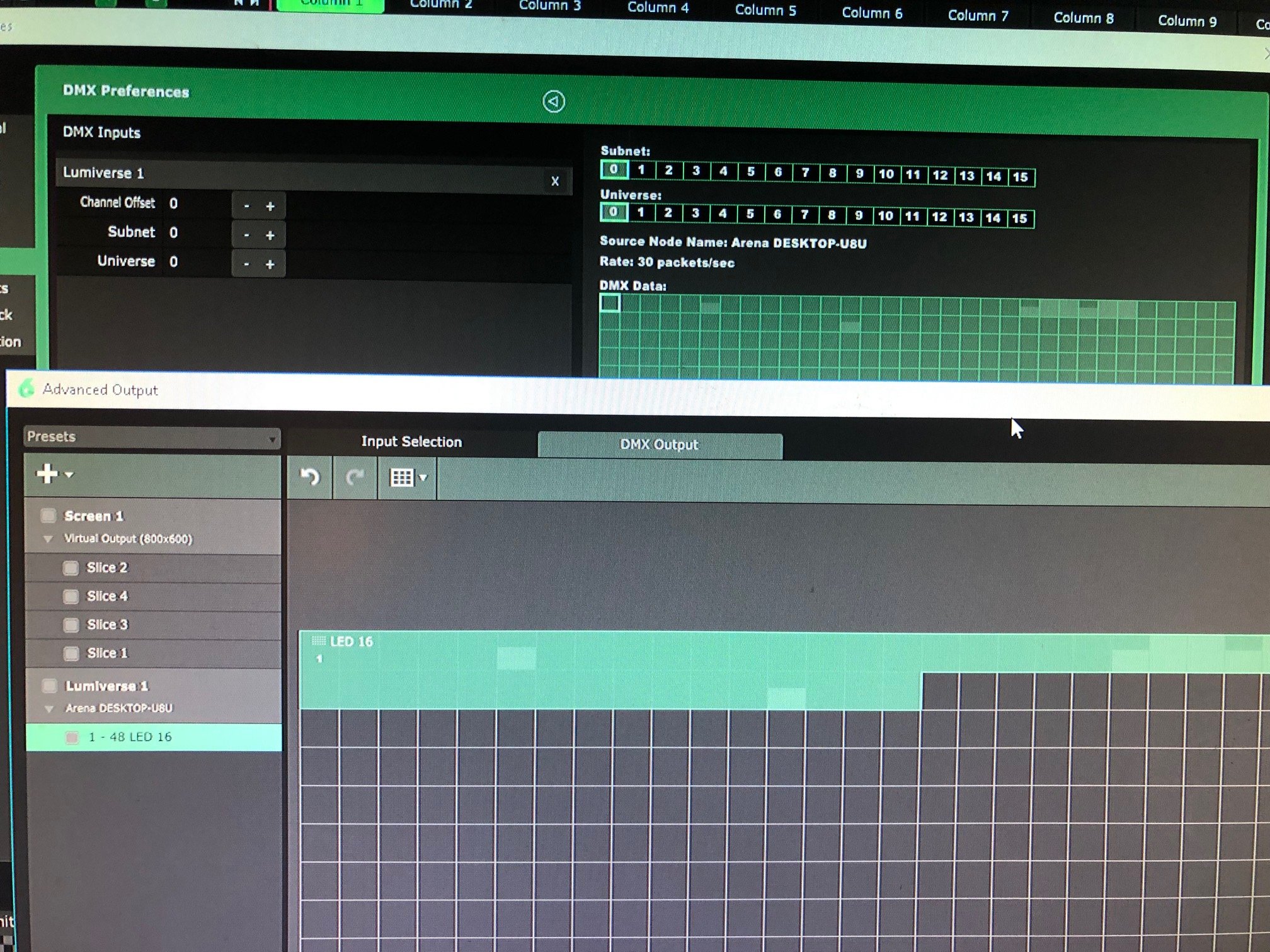

Hi, where can I find help on how to set-up a Show Jockey Artnet Node 4 to run a Show Tech Pixel bar 12 (once I have that running, I hope adding more fixtures should be fine.....)
I have tried changing the IP address as suggested in you help files (please see images)

In your last screenshot, the lumiverse destination ip needs to be the ip of your pixel node instead of the ip of the machine.
Currently you're sending back to your computer.

Thanks now got activity in the DMX data fields but not the light itself, think its nearly there though

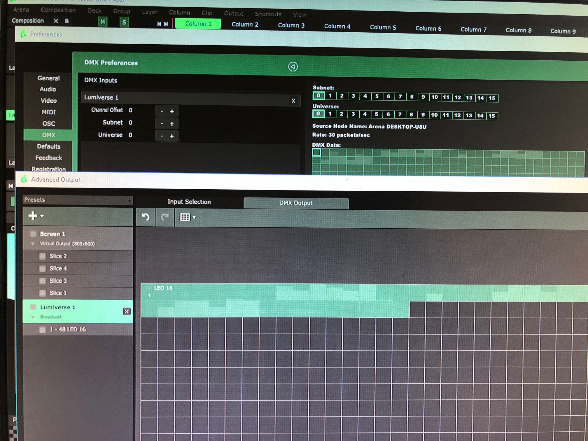

That's because you're not sending to the light's IP from the Lumiverse.paull wrote: Fri Jul 19, 2019 20:02 Thanks now got activity in the DMX data fields but not the light itself.
Try Broadcast if in doubt about the IP.

I have switched to broadcast and still no joy. Thanks

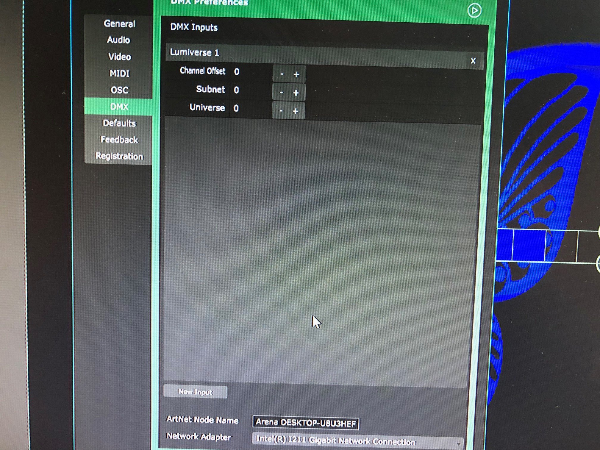

How do I find the the light's IP to target from the Lumiverse?

Will the IP then show up in the list of Target IP for Lumiverse 1 which currently says:
No Output
Broadcast
IP Address
2.0.0.10 Arena Desktop

If you haven't changed the IP, it might be still the default.
They say and show it in the video you linked: 192.168.1.200
Try resetting the device as shown in the video.
Then you need to set your computer to the same network range, for example 192.168.1.100.
After that's done to restart Resolume, and set the Lumiverse output to 192.168.1.200.
If you still can't find it, try a network scanner tool, or contact the manufacturer of the device.

All sorted now thanks to Jodge at Show Jockey, despite time difference and language barriers. We Whats apped and video linked and sorted it.
Like I said I was nearly there....
The ArtNet 4 needed a hard reset and then the IP sent to my PC. This was done using a nail pushed through the hole as shown in the video https://www.youtube.com/watch?v=OjKiY4wC7-o
Once done the Art Net showed up in Resolume, but at IP 192.168.1.10
