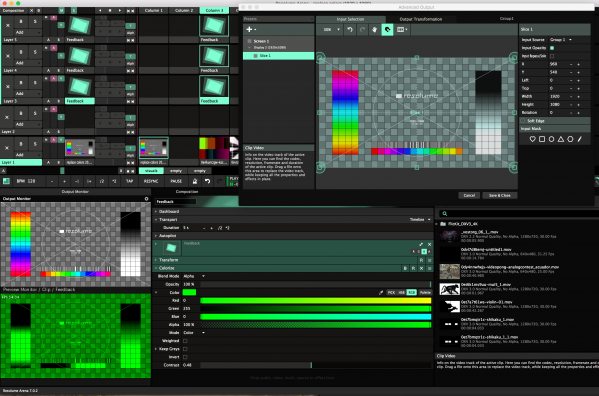

If you're talking about a led wall, try to
make a new group, bypass it,
add 2 additional layers to the group
add Feedback sources to every group layer.
On Feedback 1, disable all but the Green channel in the Feedback source, and drop a colorize effect to the Feedback clip, set colorize color to Blue, set colorize weighted Off, and contrast to 48.
On Feedback 2, disable all but the Blue channel in the Feedback source, and drop a colorize effect to the Feedback clip, set colorize color to Green, set colorize weighted Off, and contrast to 48.
On Feedback 3, disable all but the Red channel in the Feedback source,
Launch all Feedbacks, and set your Slice input in the Advanced output to the Group,
Disable Ignore Bypass/solo on the slice.
This would give you a result like this: But checking the LED hardware setup first would be recommended in either case.

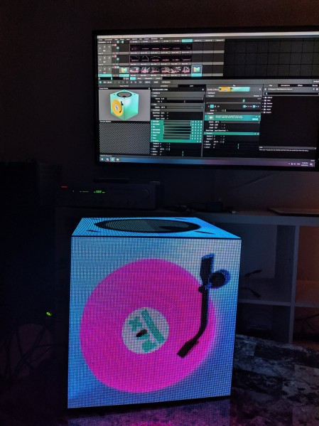

Good call on the color space, I'll check that tonight with my DVI monitor. The colors *were* correct initially, then after I changed the brightness and saved the settings is when I saw the color error.
Here's an example of the colors showing incorrectly, just for reference. There no red here, but red does display correctly.

I didn't see an option to change the color space in my GPU's outputs, so I remapped green and blue in the Blender compositor when rendering video and everything is "fine" now. I still need to fix the core issue but at least it looks correct now.
