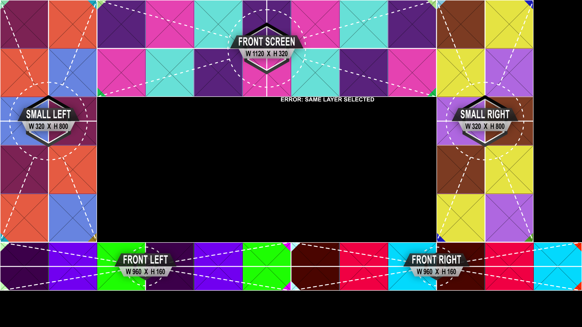

I create screen maps using the AE template from Dvizion, and i create these based on the specifications of the led wall supplier for their processor(s) (see attached)
I load up this image in Resolume, i create a slice for every led wall screen, position & size it exactly on every screen on the input map. On the output transformation i select all slices > "match input shape" .
At this point all slices are the same on input / output, and everything looks great, i can verify that the led processor is configured right & everything fits perfectly.

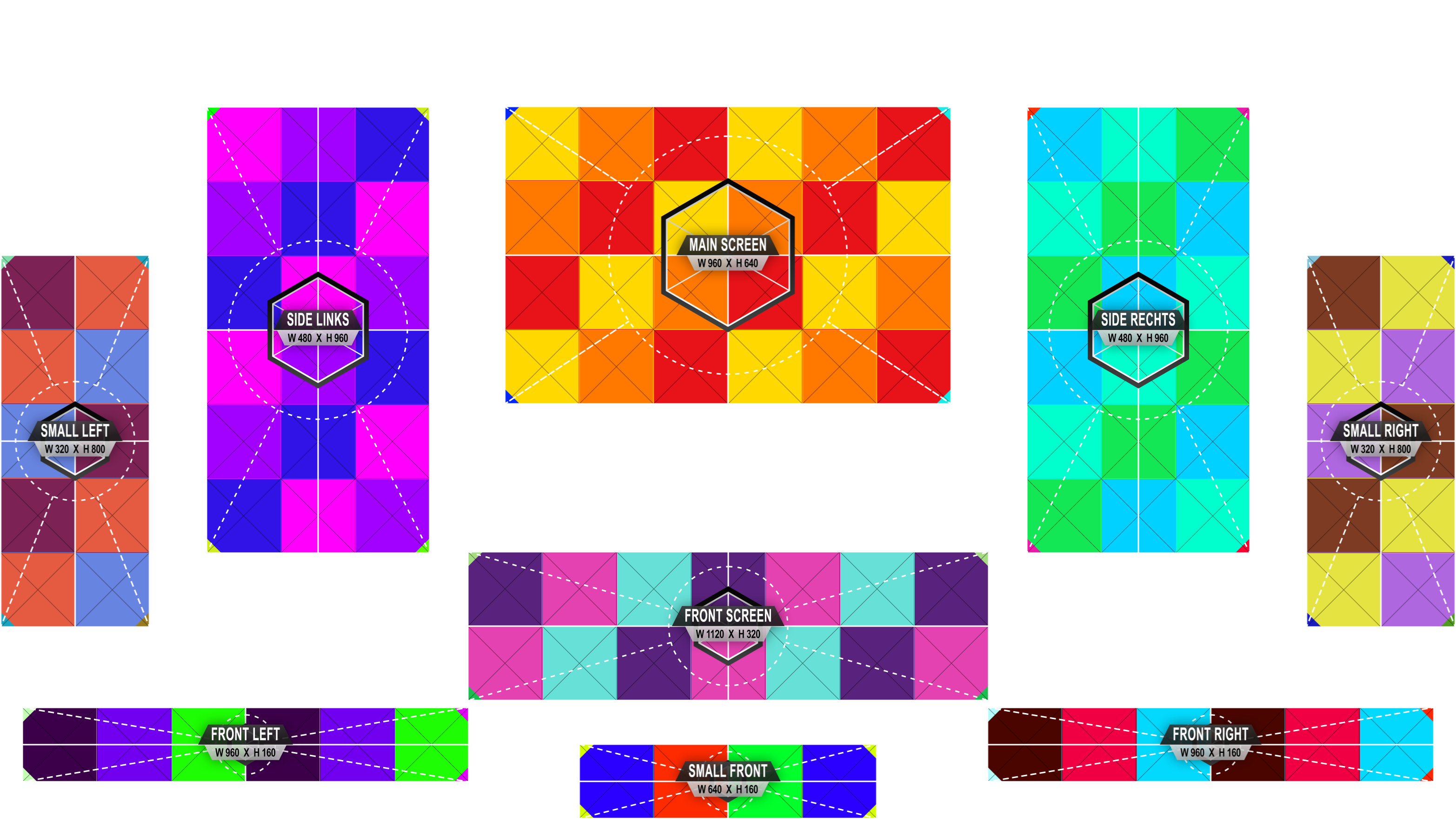

I put the slices on a bigger canvas in AE and put them as close as possible to the physical layout on stage.
Because of the negative space inbetween screens , the canvas is 3131 x 1762px .
So to have content pixel perfect , i need this template to make my content, and set the resolution in AE to above numbers ?
Resolume composition also on this resolution, align input slices with this template map , but i leave the output as was tested for the processors ?
But then if i need to use stock content which spans the entire canvas, it has to be 4k , or i need to scale the entire map to 1920x1080 ?

working with LED walls the output have to match the prozessor / supplyer stuff and you mostly work on the input side (so that your content and the slices match your needs)
working with projectors you mostly map around on the putput side and just match input shape (and may scale when more then 1 projector is used)

I'm going to do a LED mapping live stream, probably in the children of the input map page, sometime in the upcoming months to get some of the mysteries out in the open. i'll post a link on here as well.
it's actually 100% easier than mapping beamers.
