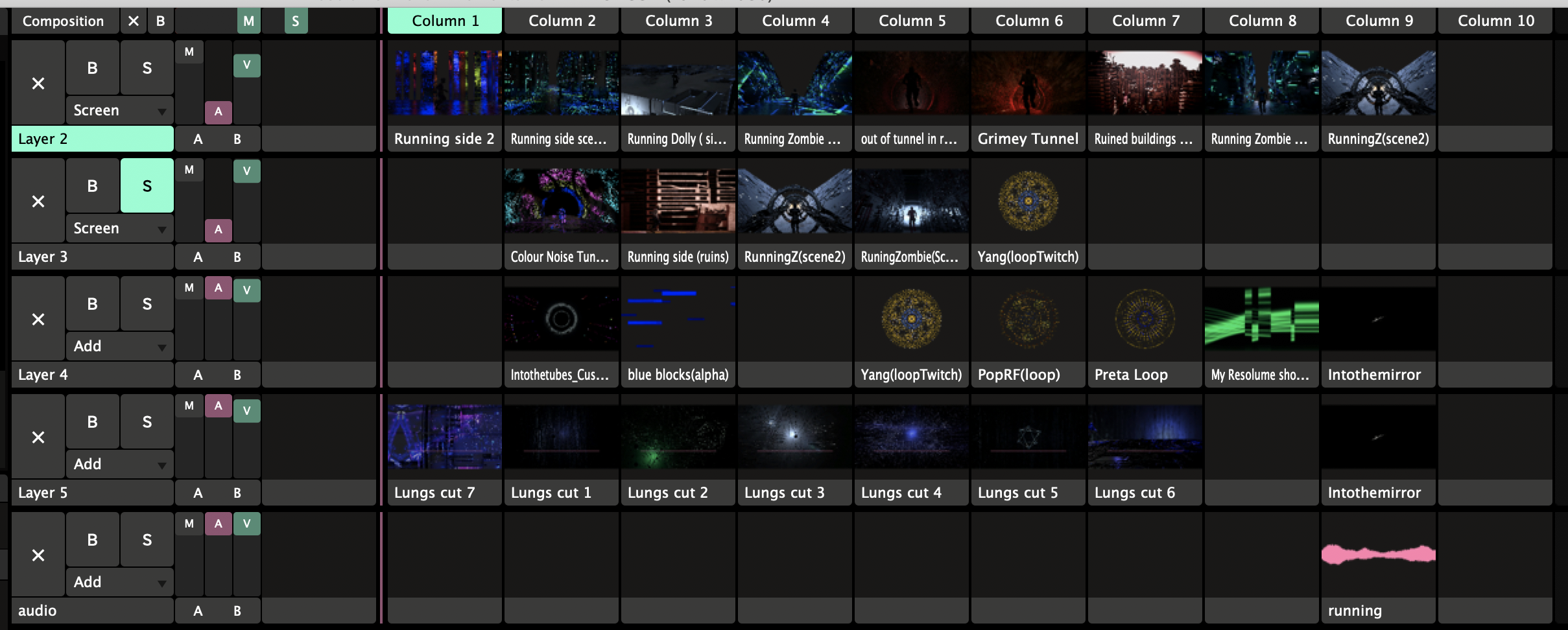

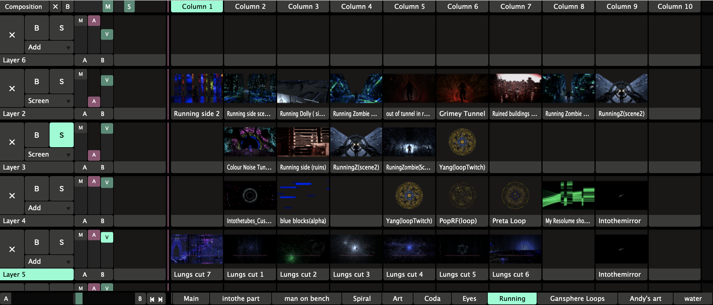

Basically Resolume keeps adding a blank layer to the top of my decks. I get rid of it, save the show, click around the decks and it's added again like some phantom layer. I can't get rid of it.
I'm controlling my show clips with an APC 40 so the extra layer that keeps appearing will throw out my all of my midi clip controls.
Anyone have any ideas here, it's driving me up the wall. :?: :?:

Do you have only 5 layers in all your decks?

He2neg wrote: Thu Apr 09, 2020 12:18 Do you have only 5 layers in all your decks?
Ahhh, there was a hidden layer ( from my view ) under one of the decks. Deleted it, now sorted thanks.
