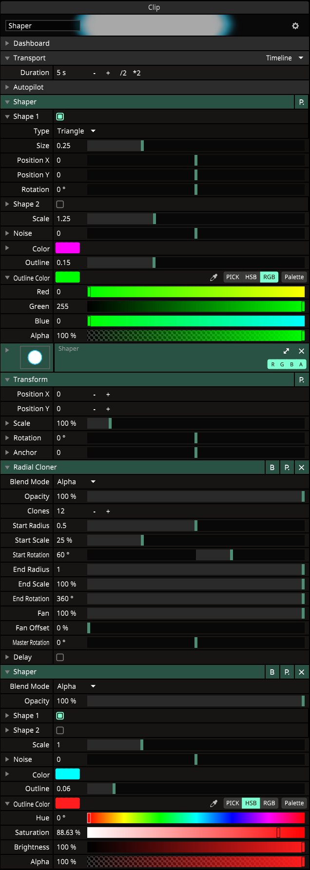

There probably are a number of ways to do this.
This is what I came up with quickly.
I used a Shaper Source, Radial Cloner Effect and another Shaper Source to fill in the middle.
I left the colors in so the edges can be seen.
