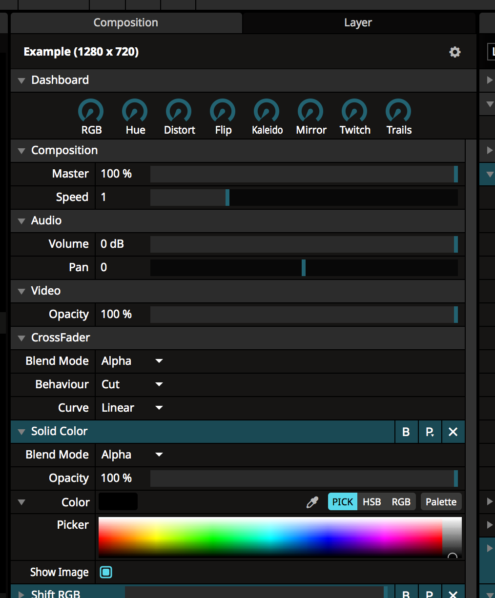

Maybe the device is unable to process the alpha channel. To check this quickly, try the Solid color effect on the Composition, with Show image enabled, and color set to black.
That should work to fool the NDI converter.
