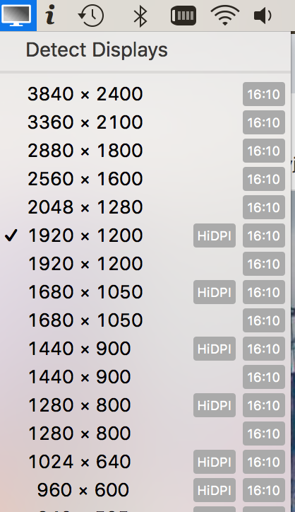

Re: Wrong resolutions only on Resolume
Some of these resolutions might be a HiDPI resolution.
OSX uses these to do scaling of the UI elements, but it will still show you images or video at the display's native resolution.
SwitchresX can tell you if the resolutions available are HiDPI
Here, for example I have 2x 1920x1200 resolutions for my built in display which is native 2880x1800
For best Results on the output, make sure your output display is set to a non HiDpi Resolution, so running at a natively supported resolution.
(very similarly to Windows, where the display scaling should be 100%)
Post by vejas »
Just a follow up, the double resolution seems to happen when you connect to a graphic mixer, it happens randomly, means that one day is ok and other it doubles, it happened when I used a analog way rs4, fortunately as Zoltan said with switch res you can disable the hidp mode, I also wonder where Resolume take the resolution because tested with millumin and madmapper the resolution appears correct.
