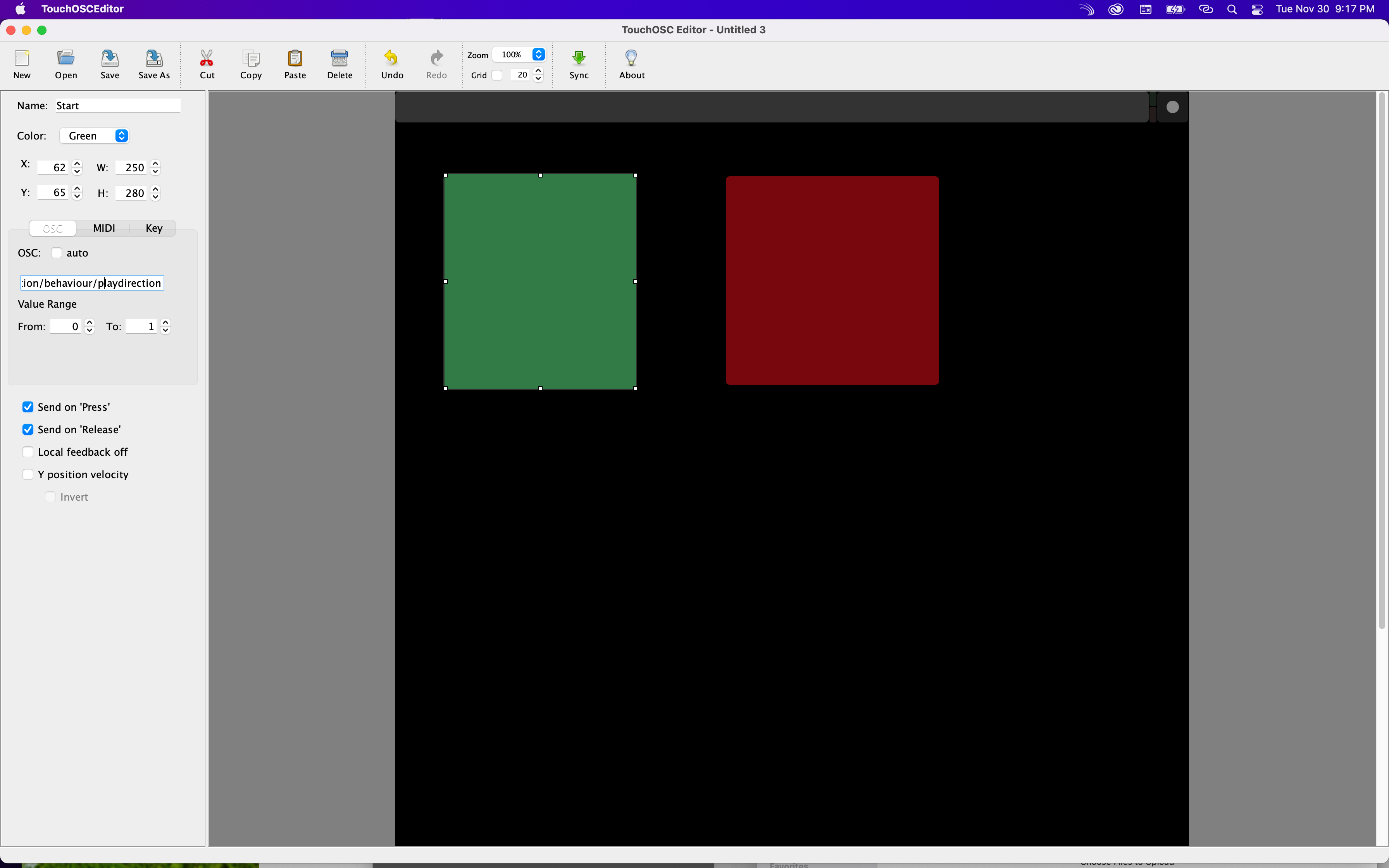

I am using Touch OSC to control RESOLUME 7.
I am having problem programming Touch OSC .
I was told that using:
/composition/layers/1/clips/1/transport/position/behaviour/playdirection ,I need to add an integer to differentiate the action on the same address.( when clicking on the pause or forward button, both has the same OSC address.
I was told to use int0=backwards, int1= pause, int2=forward.
Using the Touch OSC editor , I am not seeing an option to enter this int values.
Anyone could hep where to enter it?
I see the value option but it has no option to specify that it is an INT command.
Thanks in advance.
Re: TOUCH OSC integer value pause /start button
it's the value range in your image
