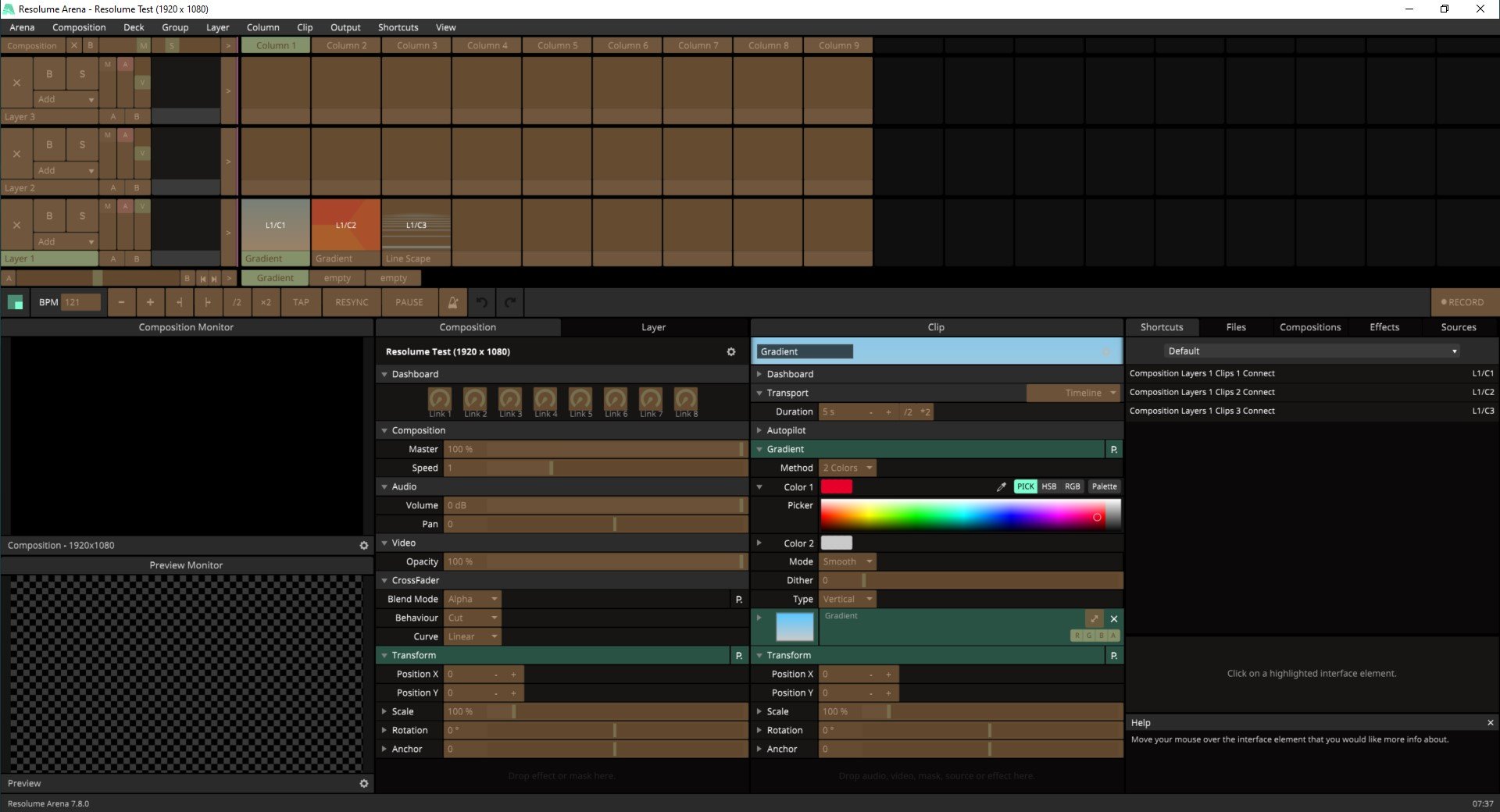

I have set up three channels to trigger 3 clips as a test at this stage. Channels are 1 to 3 on DMX 1 to 3 and all on DMX Universe 1.

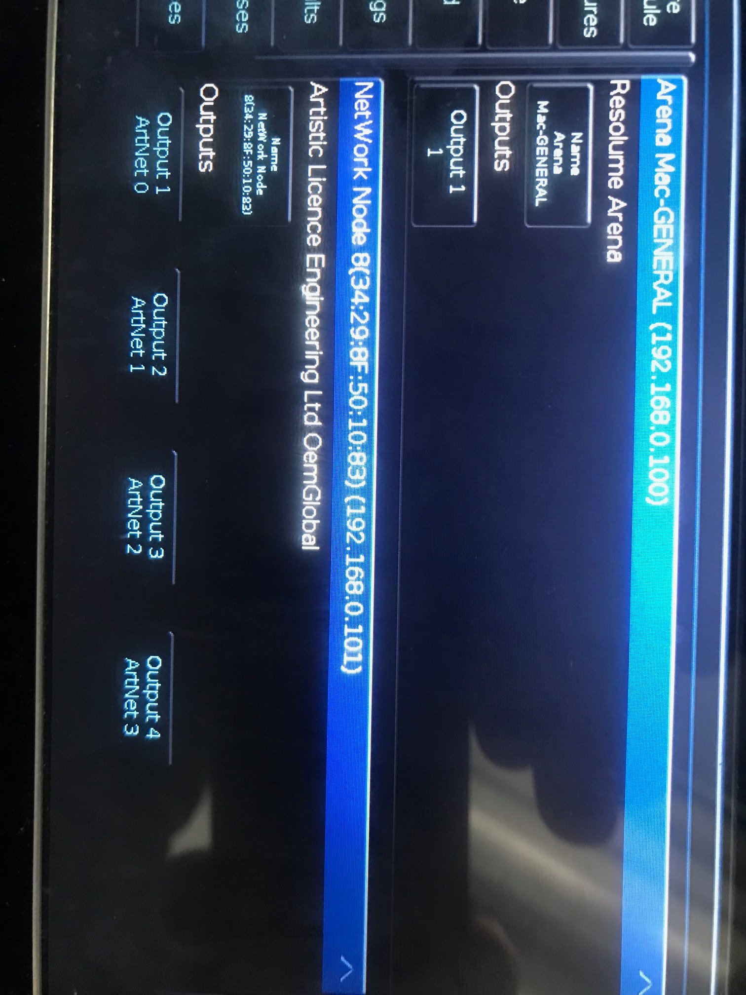

DESK - Please see (FLX Desk View) image. This to me indicates the desk is seeing Resolume on my PC but it did not trigger the clips when I activated each channel to 255. The DMX preference for network adapter was set to ethernet.

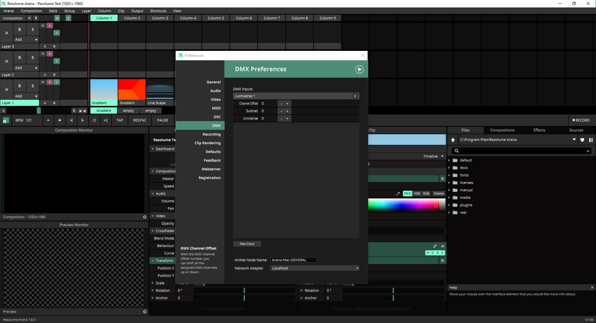

PC - I have set Resolume as per the attachments (PC -DMX Preferences, PC - DMX Shortcuts).

This should be set to your ethernet interface: https://resolume.com/support/en/dmx-sho ... rk-adapter
Képernyőfotó 2022-01-24 - 14.18.45.png (64.81 KiB) Viewed 12172 times

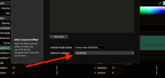

OK, got back home and tried Resolume and the lighting software on the same PC and they are still not talking to each other. It is a Win10 PC.
I changed the Resolume network adapter to 'Localhost' for this.
Is there anything else I need to change please. As I am now confident I have set up my DMX shortcuts correctly as I have triggered them from my desk.
Posts: 7771
Re: Lighting Desk to Resolume (DMX-Artnet) Setting Up
It's probably the port conflict then. You could try to run the DMX app on another machine on your home network.
