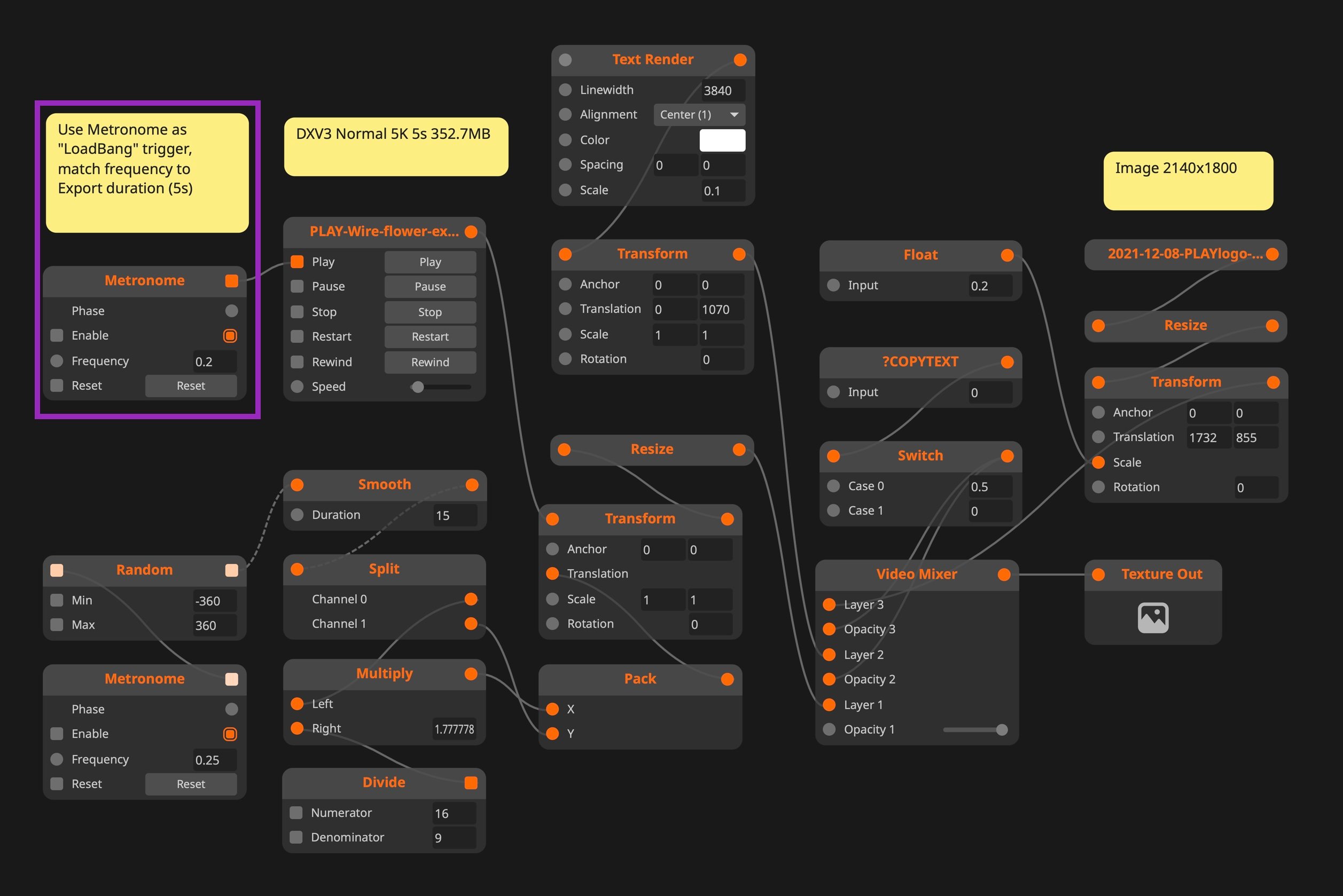

I think I've figured out what the problem is. I tried with a shorter 5s DXV video (5K). Same happens, on export I only see the additional elements introduced in the patch (see attachment).
I think the problem is that on Export the Video Player does not start (and if it is already running, with a much longer source video, Export does not see it).
Is there something the equivalent of a PureData loadbang that triggers on patch load or export?
Q: I need to trigger the Video Player to play when it Exports.
EDIT: I can use Metronome as pseudo "load bang" then the Export works, but not sure about the timing. It's a bit fiddly because have to match the Metronome frequency against the expected Export duration.
Q: Can you confirm whether an enabled Metronome indeed re-starts cleanly on Export?

Transport play node has triggers which you could use, the Play outlet should be the one to use, to the Restart inlet of the video player. (Play won't rewind ;)
