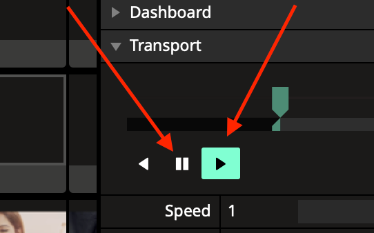

If you pause a clip, and trigger it again, it will still be paused at the same position.
..................Pause............................................................................Play
Képernyőfotó 2022-02-18 - 15.28.51.png (30.34 KiB) Viewed 4622 times

Can an automated pause point be set in the middle of a clip though?
So if there's a 30sec clip, when I trigger that clip to play from the beginning, can I have it automatically pause by itself at 15sec every time, and then I can manually unpause it to play through to the end of the clip?
Re: Set pause point in middle of clip
Use autopilot, a blank clip, then duplicate your clip with a different start point. Or bake it out with a pause
