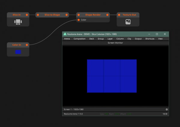

Hello dear Resolumes,
using the "slice to shape" or the "shape render" node generates a 1px black border - don't know which of these. Visible if you snap the slices together in the advanced output. Is this on purpose?

You can loose the slice to shape and go directly from slice to shape renderer.
Then in your shape renderer turn the AA to 0 ;)

In this scenario yes.... but this don't solve the problem in my other projects ;)
Re: Wire - Slice to Shape creates black borders
AA is your problem, so yeah, it should :)

I've checked it. And you where right. Anti-Aliasing was the problem.
AA to 0 caused some ugly ladders.... but Changing AA from IN to OUT does the Job for me.
Thanks for pointing me in the right direction.

Also there is a slice render node ;)
