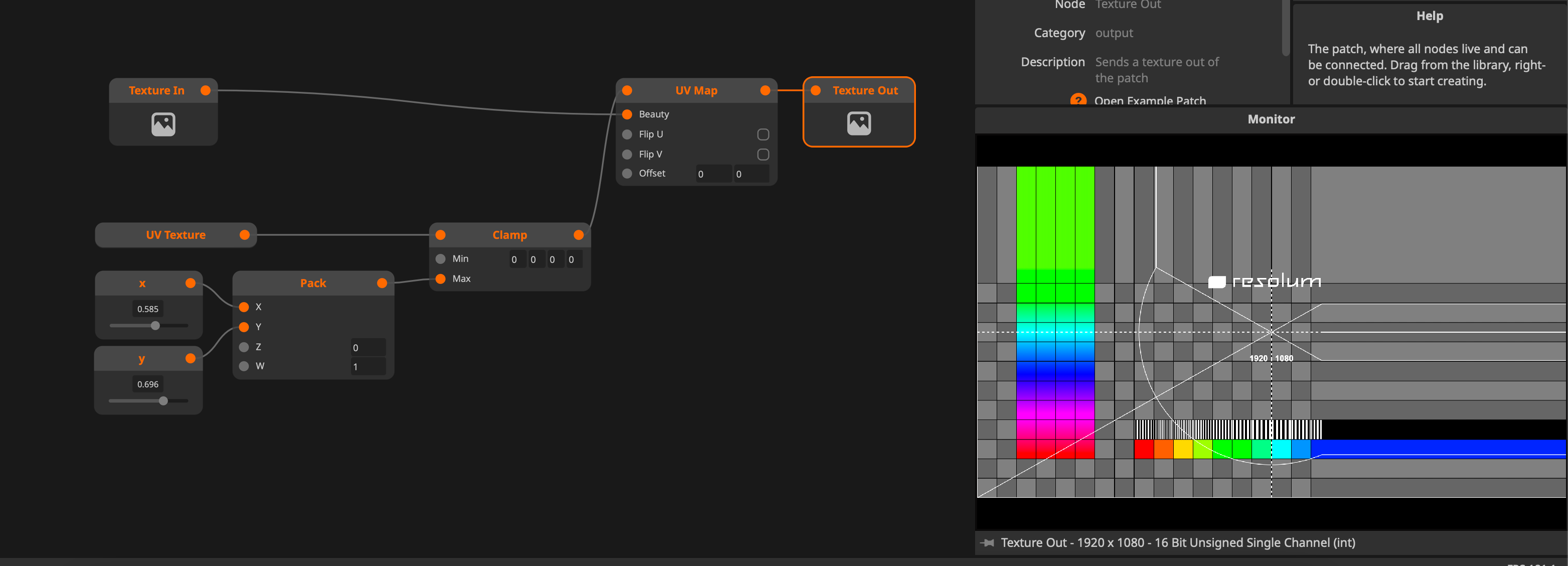

It's all about playing around with UV coordinates.
I attached a patch that uses the UV Texture and UV Map nodes to implement a simple Blow effect.
The UV Map uses a UV Texture to determine where to sample the pixels. The red channel of the UV Texture determines the X coordinates and the green channel determines the Y coordinate.
By altering (in this case clamping) the red and green channels you can manipulate the x,y coordinates uses to sample the pixels.

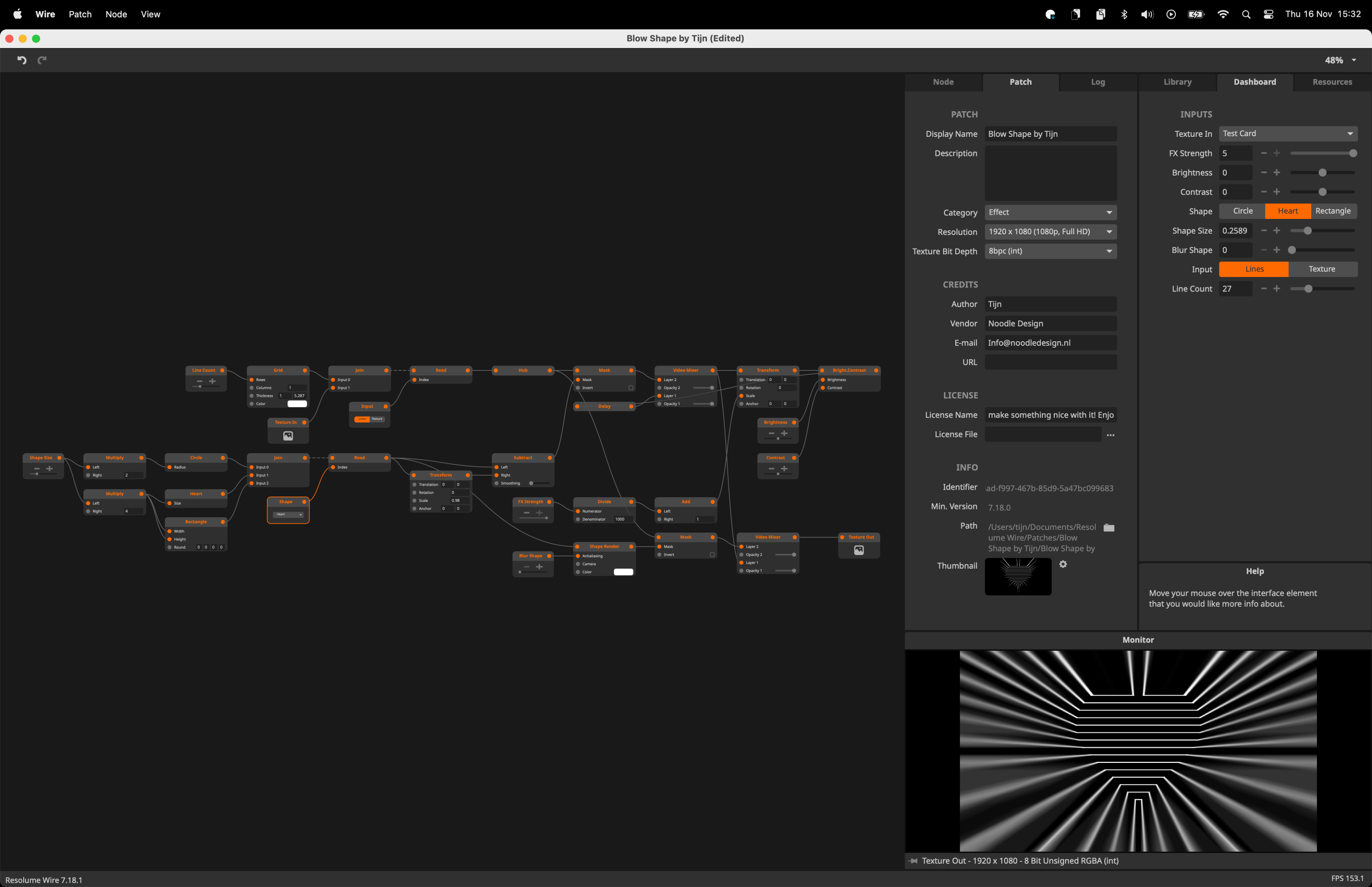

This was a fun one. I was trying to come up with a solution, and I came up with this. It's not really a blow effect, but it can makes similar effects though. And it really a nice fx on it own. I used a feedback to get the fx. I will include the patch, and also a compiled version for Arena (.cwired) for all of you that don't have wire... Enjoy
- Attachments
Blow Shape by Tijn.wire- (90.83 KiB) Downloaded 588 times
Blow Shape by Tijn.cwired- (732.32 KiB) Downloaded 572 times

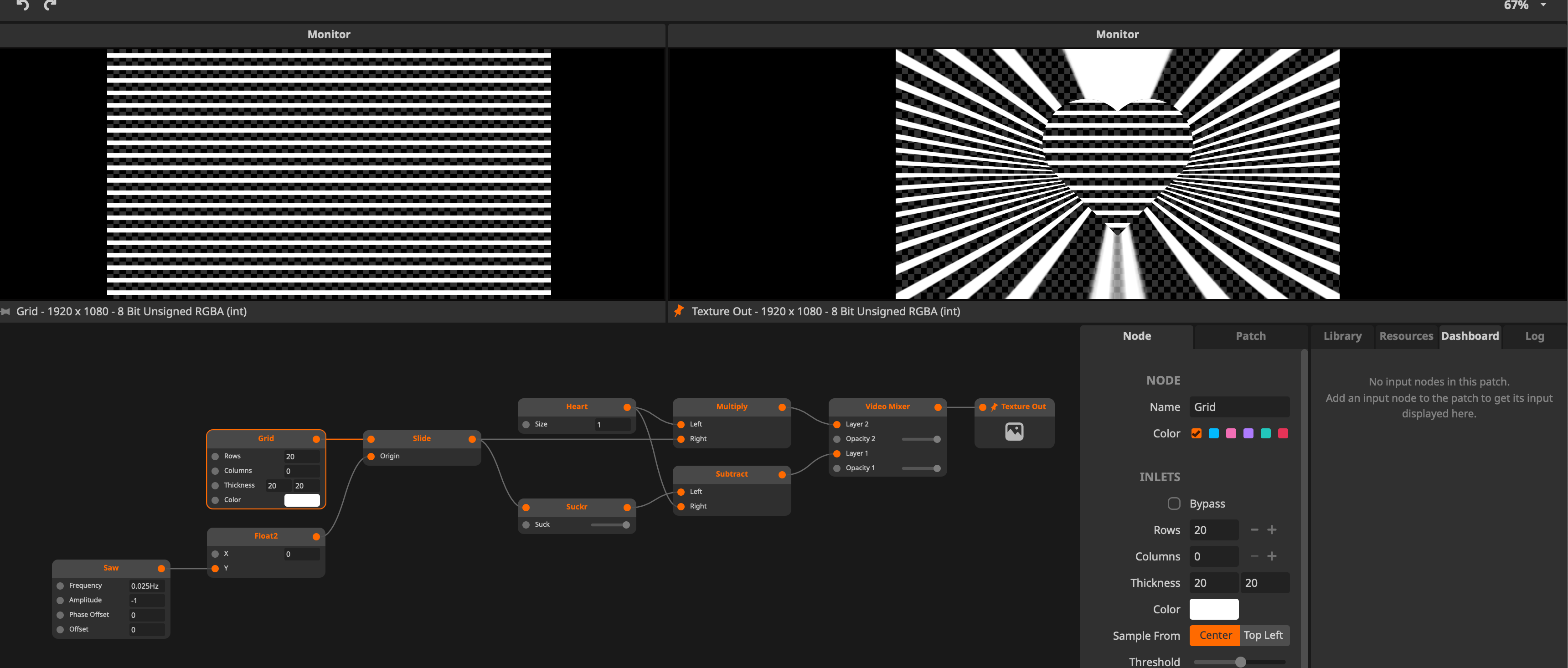

Here is my version, faking it a bit but looks quite convincing:
