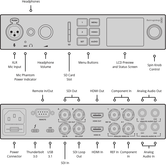

Hey folks,
does anyone have some experiences with the BM Ultrastudio 4k mini?
As you can see, the device has two SDI outputs. A and B. My questions is: Are they independent?
I cannot find any detailed documentation on the internet nor any review which does mention any further information about these outputs.
Best wishes

Hey there..... just to close this thread
Mail from Blackmagic:
///// MAIL /////
Unfortunately the answer is no the outputs on the Ultrastudio devices are not independently programmable so you cannot send different signals out of each connection. We do manufacture multi signal devices but these are in the Decklink range, the Decklink 8K Pro, Decklink Quad 2 and Decklink Duo 2. if. you want to consider these cards then they can work in thunderbolt 3 chassis such as those made by sonnet.
I hope this information is useful to you but if I can help you further please ask.
All the best
Paul
