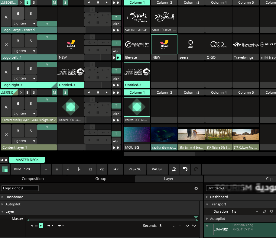

Im trying to make 2 buttons in companion via OSC send integer to fade a layer in or out but im a bit confused about the difference between layer opacity slider and layer master slider.
I put my layer opacity parameter on timeline mode with a 3 second time, play once and hold + 'continue' selected as options.
I mapped the direction control forward and backward to my companion streamdeck (/composition/layers/1/video/opacity/behaviour/playdirection)
So this works , i press "layer 1 on" on my streamdeck and the opacity slider goes from 0 to 100 in 3 sec and stays there, same for turning off, that part is all fine.
Now every time i select a clip in that layer, the slider will jump to the other end and do its fade run and hold.
So for example layer 1 is at 100pct , i press a clip in layer one, it jumps to 0 and fades to 100 on 3. every time again.
Now i solved by using the same technique on the layer "master" fader and it works as i intended.
Its a bit annoying as the fader of the layer left of the clips stays in the same spot which is visually confusing.
I dont understand why a selection of a clip triggers this behaviour on the layer control or whats the difference between the opacity slider in the layer control and the master slider in the layer contorl ?

No , its the same problem also with the master fader.

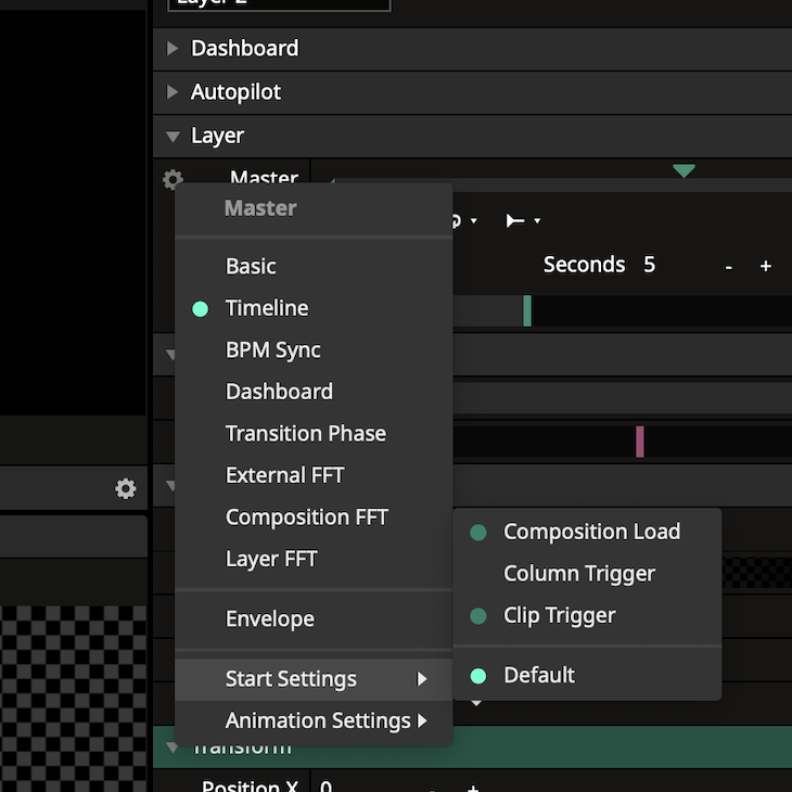

How are the start settings set?
Re: OSC layer on off slider
Ow , thats a box that wasnt there few version ago ? I should make a habit or reading the manuals every 6 months , i used to read it for every numbered version.
