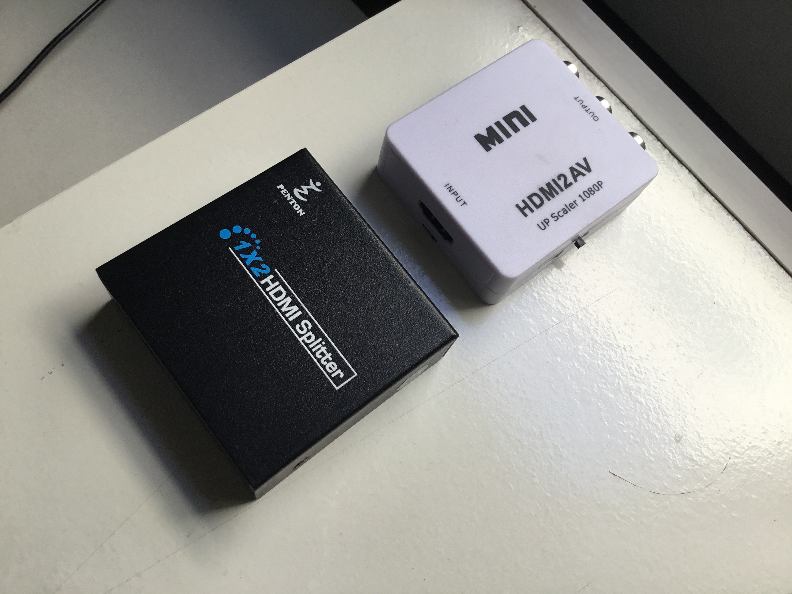

About the macbook outputs, the M1 Pro only have 2 video outputs, but the M1 Max have 3 outputs up to 6k and one 4k (hdmi).
About the use of old CRTs, if you are in a low budget, you can duplicate your outputs with an inexpensive HDMI splitter with those cheap upscalers that outputs composite signals.
I use these boxes for a long time without any issues, Im tired of those blackmagic frills about framerates, uncommon resolutions… these cheap boxes do the work just fine.
splitter
https://www.amazon.com/Splitter-Monitor ... pons&psc=1
hdmi to composite
https://www.amazon.com/DIGITNOW-Analogu ... 277&sr=8-3
