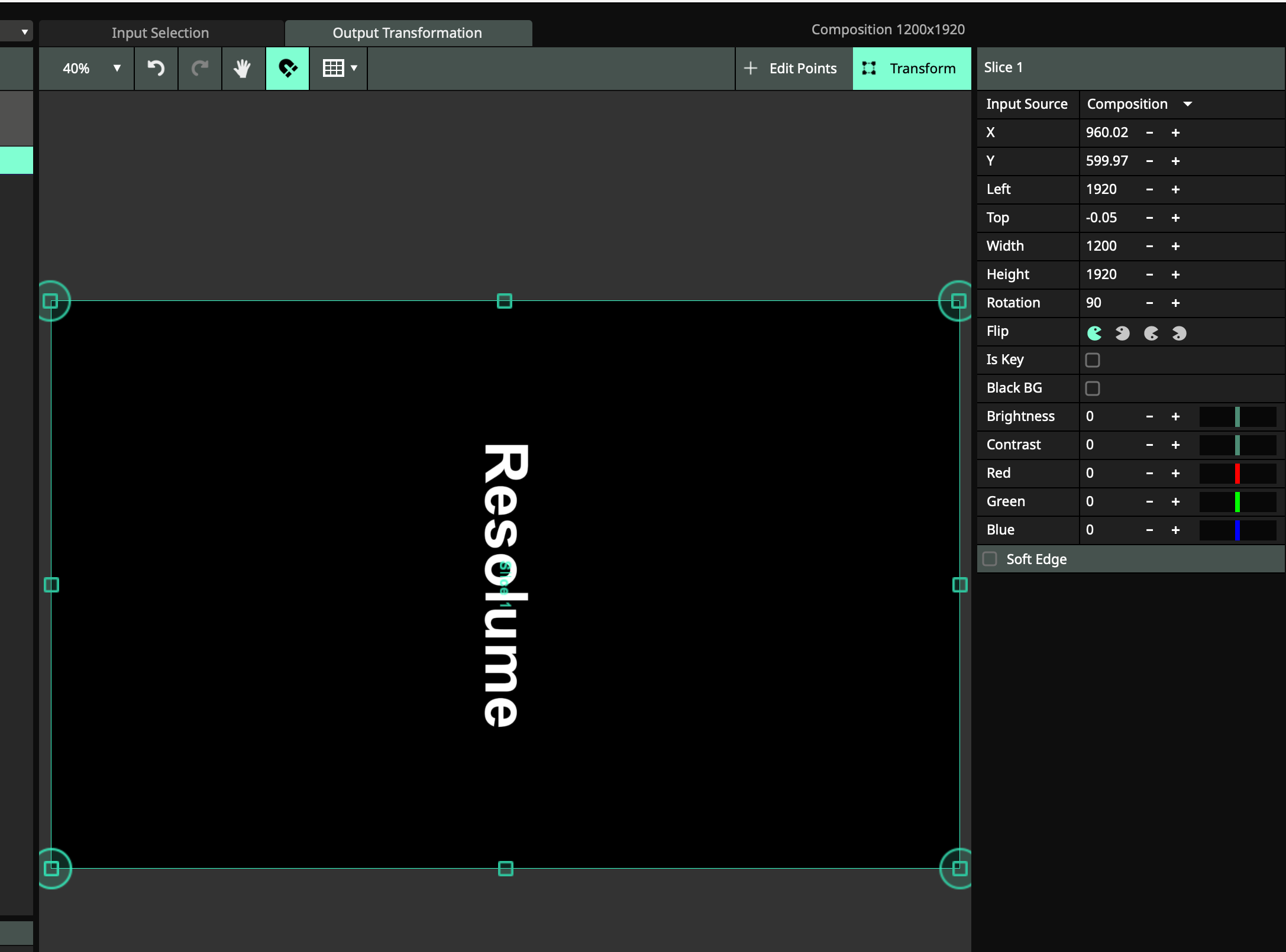

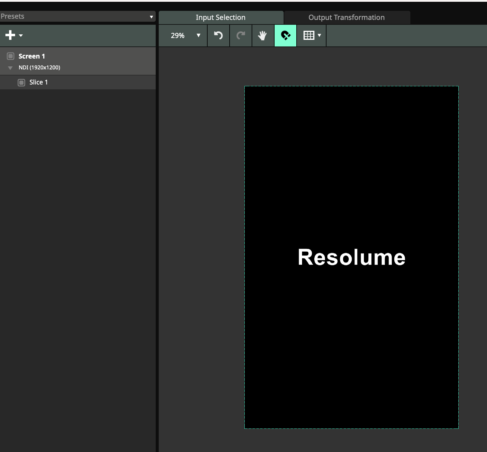

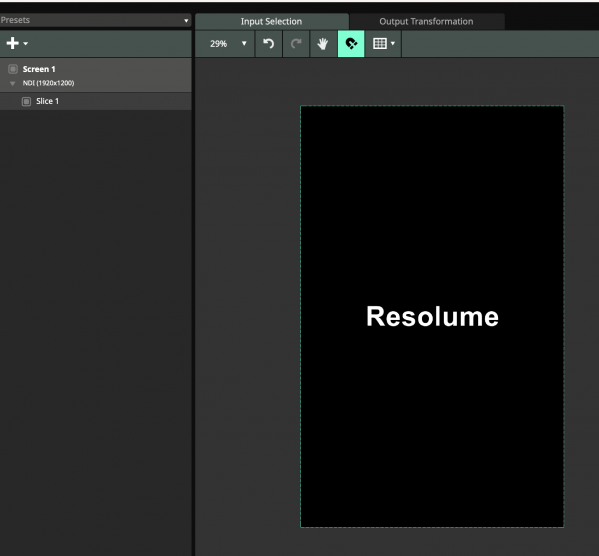

I'd make an 1200x1920 composition, and play all my content in that, so what I see in the UI will match the projector. No rotated clips, unless you really want to.
Then in the Advanced output, map the input slice to the output slice, match output slice to input slice using right click menu, and rotate the output slice.
