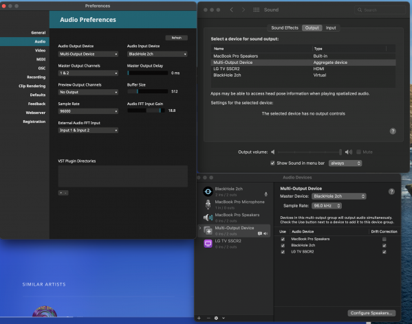

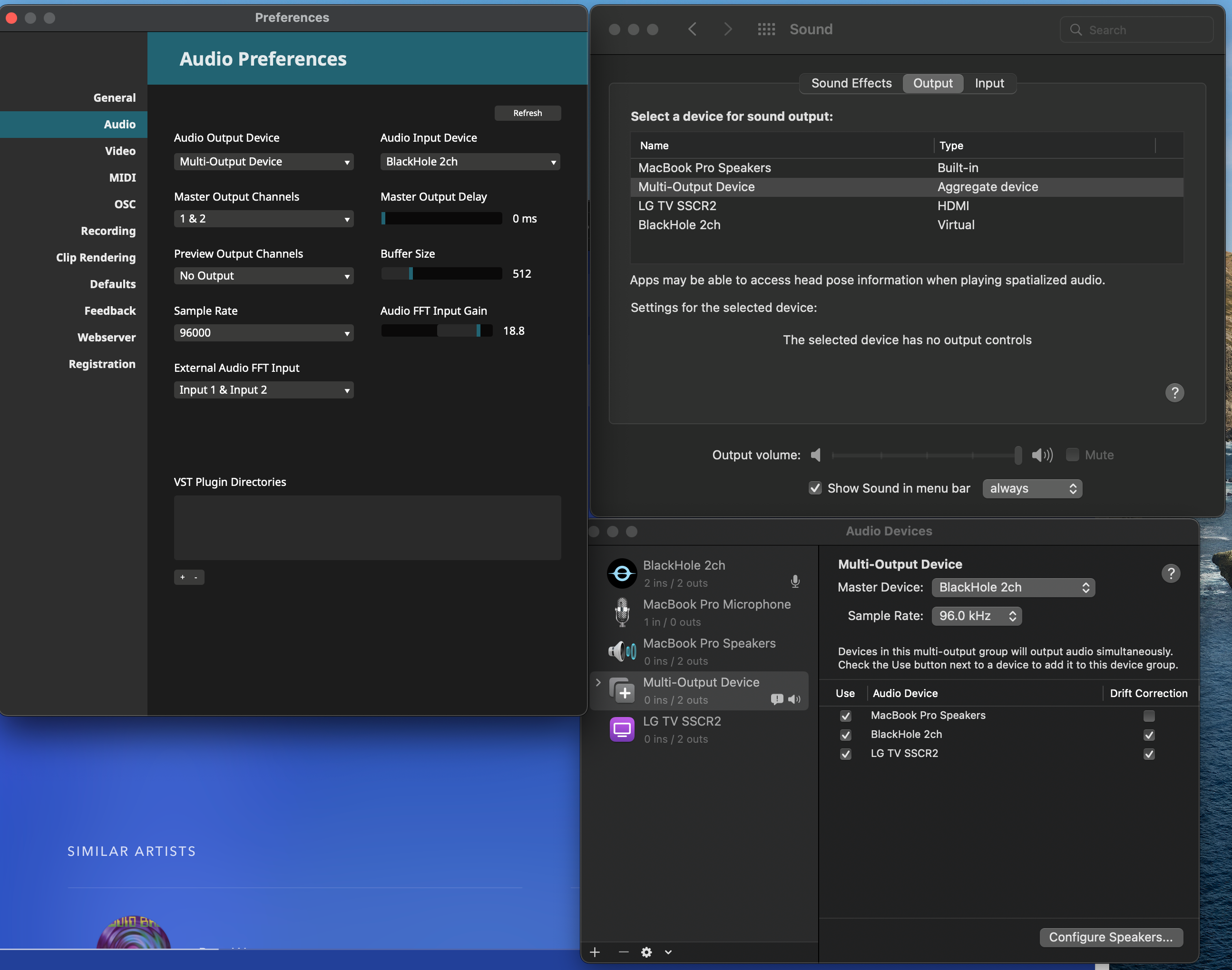

Using BlackHole and working as I want, except audio not recording with video on my M1 MacBook.
No audio on playback. Sound-driven visuals recording correctly, but no sound output with file. Both muxed and WAV files are a flat-line 0 sound. Audio+video output is on.
Is it one of my missed selections, or is BlackHole incapable? See attached screenshot of prefs.
Posts: 7655
Re: Not recording audio with video on M1 Mac
Are you playing the audio in Resolume?
Recording external sources is not possible at this time, but an external recorder like OBS could do it for you: https://resolume.com/support/en/streaming
