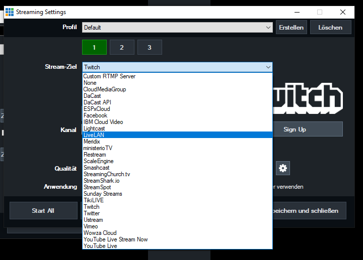

Audio is normally faster than a Video-feed....so...just delay your audiofeed in vMix
One way to preview and check if your delays fits is to use the LiveLAN Streaming option in vmix

cosmowe wrote: Wed Dec 28, 2022 12:38 Audio is normally faster than a Video-feed....so...just delay your audiofeed in vMix
Best wishes
i was aware how to delay in vMix, but was not thinking to the LiveLAN trick... thank you
