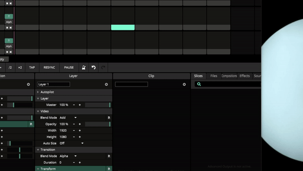

Hey there,
I found three little hickups I guess.
A.
- Open a new comp
- Add one video clip with audio to the deck
- Right-click "Strip Video"
- UNDO
= The clip shows that it wants to get relocated. But it's actually working.
B.
The "Key Hue" within the ChromaKey FX has no Color Picker. Is that on purpose?
C.
The next is a hard one...this issue exists for a while now. But it was not possible for me to recreate it consistently. It just happens, sometimes.
Today I gave a little Resolume course to a colleague via discord. He screen-shared his Resolume UI and it happened to him also...so maybe here in the forum is also someone who saw this little bug!?
- Set video and audio default Playback mode in the preferences of Resolume to "Play ones and hold"
- Insert a Video Clip to the clipdeck.
= It is not set to play ones and hold. Instead, it is still set to loop.
This also already happened to me when I was adding a bunch of clips at ones. For example when I added 20 Clips from the windows file explorer via drag'n'drop to a clip deck. 19 Clips where set correctly to "play ones and hold" but one clip was set to "loop"
This sadly only happens very rarely...And for me, it never was reproducible. It just sometimes happens..
Over and out

Thanks Cosmowe!
A. Hmm, works fine on windows and mac for me. The relocate flashes up a bit, then the clip shows the video thumbnail again. DXV AV clip?
B. Chroma key is pretty old. There might not have been a color picker yet in Resolume, when it was first made.
You can build a chroma key effect in Wire which would have a color picker.
C. yes, we have a ticket for it

Thanks for your reply.
to A:
Yes this also happens with DXV. Just double checked it.
to B:
oh, I thought that the color picker replaced every color chooser. Thanks for clarification.
best wishes
Posts: 1627
Re: Strip Undo Relocate hickup ++
Zoltán wrote: Tue Jan 24, 2023 14:39 Thanks Cosmowe!
Where you able to recreate this?
Posts: 7795
Nope, works just fine for me, doing the same thing you did in the recording.
The clip is working fine for you with the relocate button on it, right?
Posts: 1627
Yes right.... it just seems to be a display error
