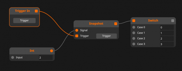

I want to use a trigger in to quickly reset a patch that is feedback dependent. This can be done with a couple switches, but switches don't accept trigger ins. Can switches please get the function to be triggered?
(The workaround now is using a delay on the trigger, and feeding both the trigger and the delayed trigger to a toggle that can talk to a switch - but that feels kinda stupid)

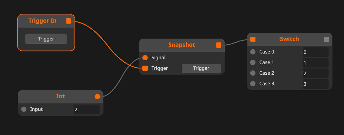

Trigger doesn't have a value. Toggle is bool, that's why it works.
To make a switch go to a pre-defined state, store that state/value to an int or bool, and use snapshot with the trigger.
