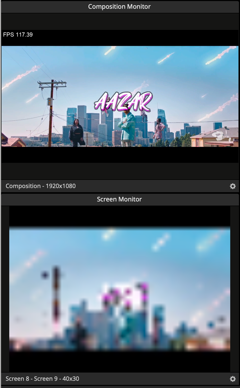

Re: LED Wall Simulation in Virtual Output.
You can set virtual output screens to any resolution, then you can preview that in the monitors.
