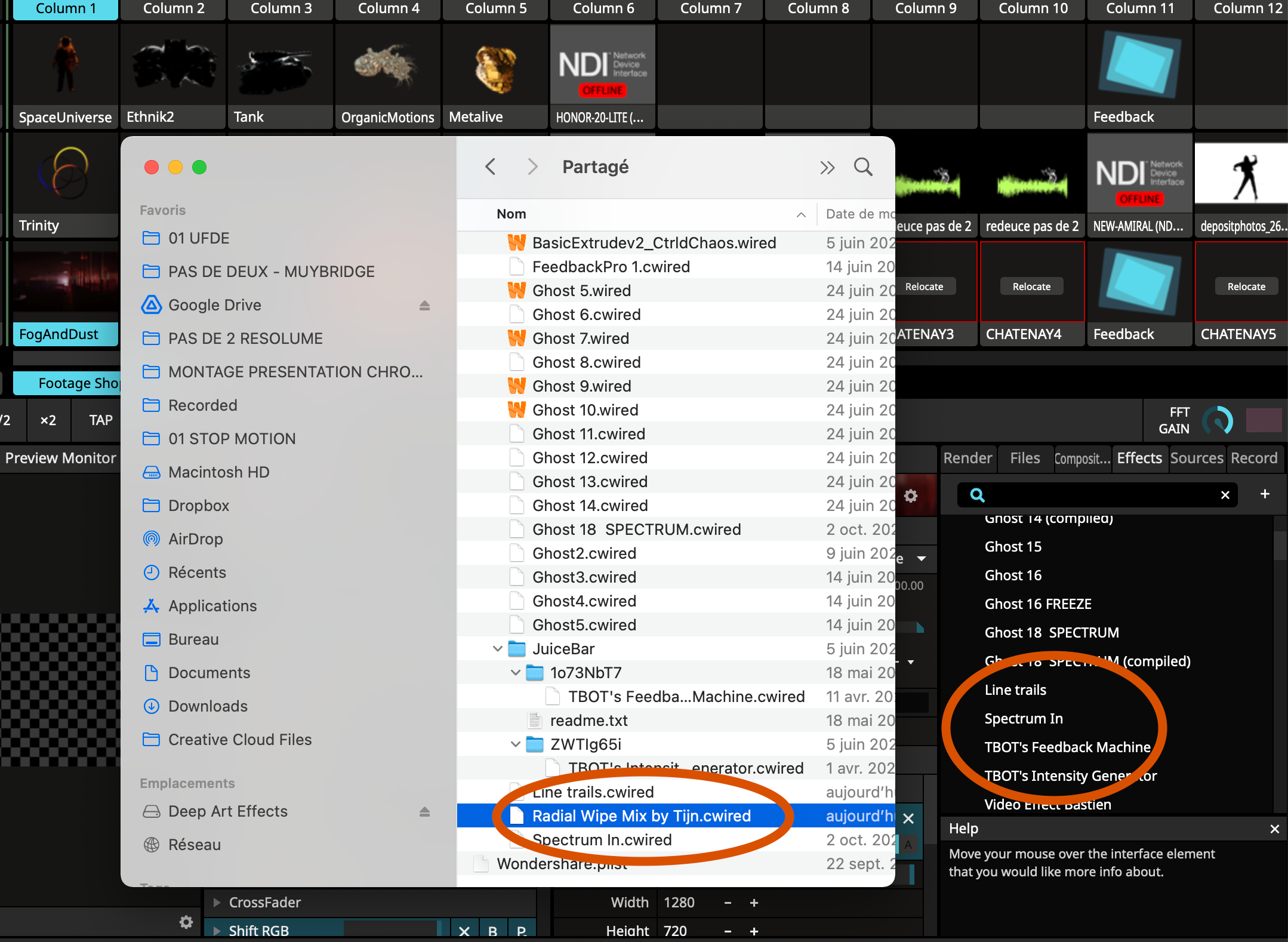

Actually, I can't use this patch. As it's shown in the attached screen capture the patch is well copied in the Patch folder but I can't find it in the Wire effect. Maybe is that because I work on Avenue, not Arena (but I'm not sure). Maybe would you agree to share the editable Wire Patch? I have a Wire licence.

Hi, if you installed it, you can find the plug-in in the blend mode section not the effect section....
let me know if it works....
