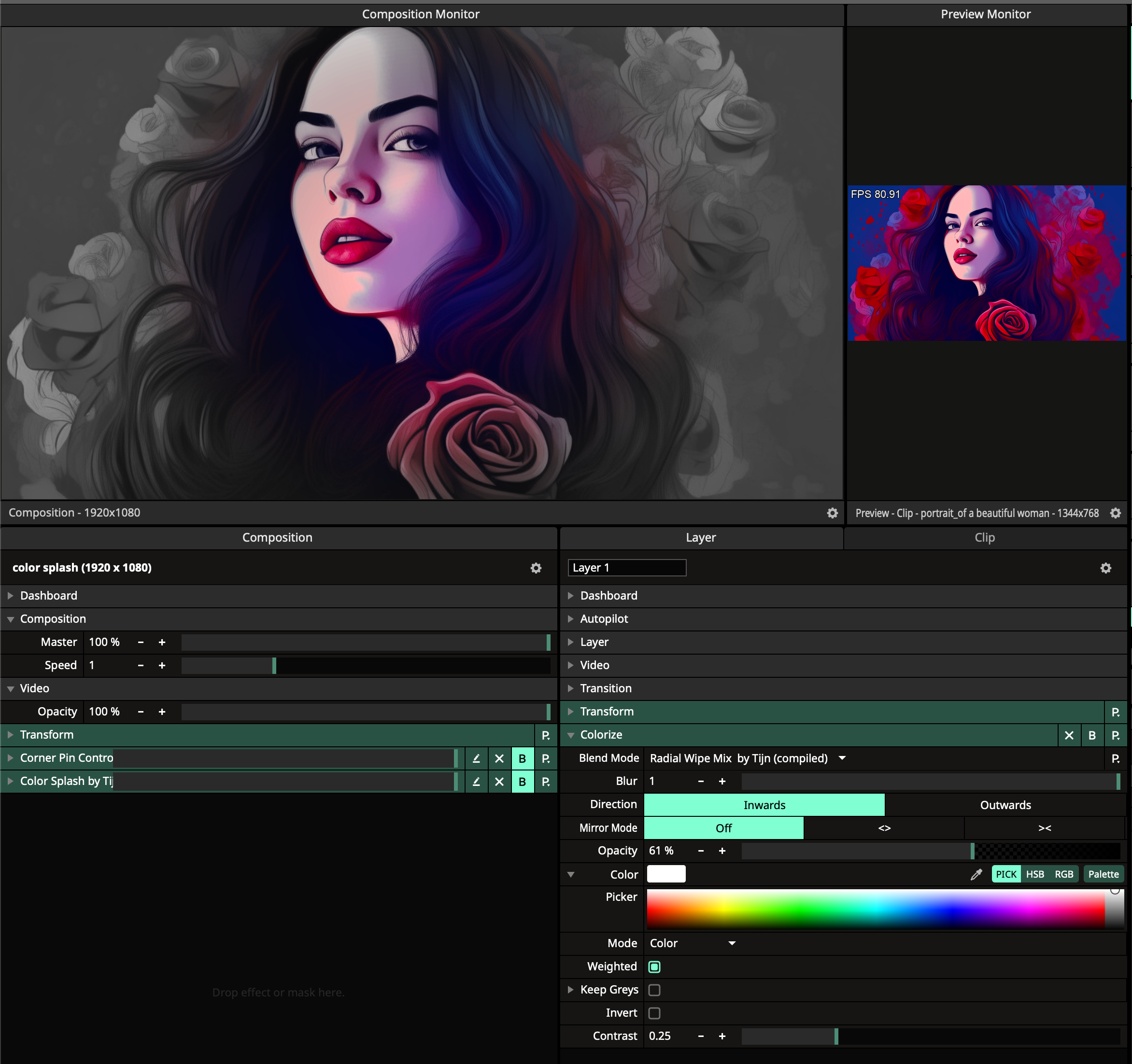

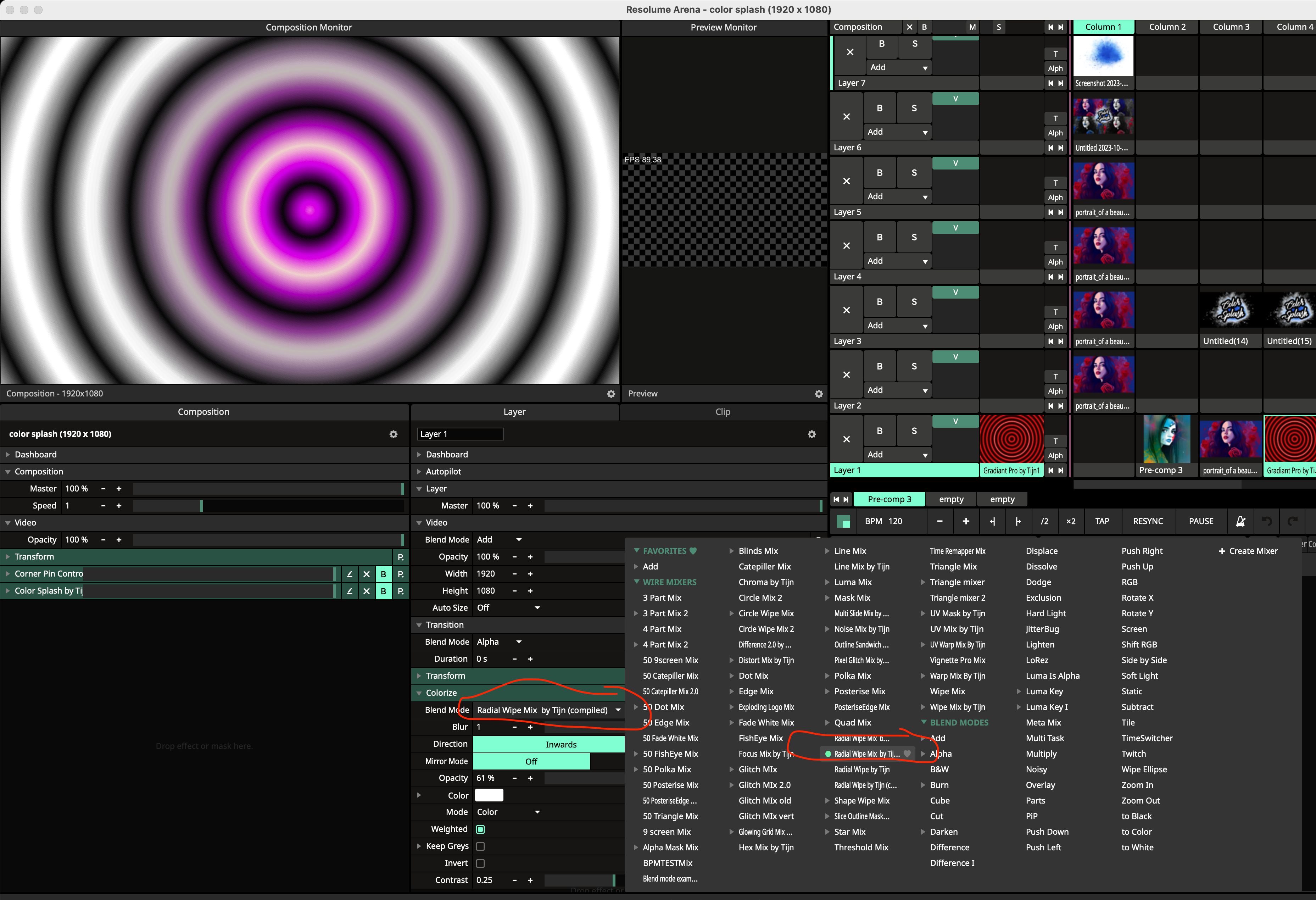

I would go a different route. I would use a radial wipe blend mode on the effect that you want to desaturate. I made one for you (and everybody else who is interested) just drop it in Arena and select it as a blend mode on the effects, and play around with the controls. You won't see anything happening until you take that opacity of the effect down. I hope this will solve your problem. Enjoy.

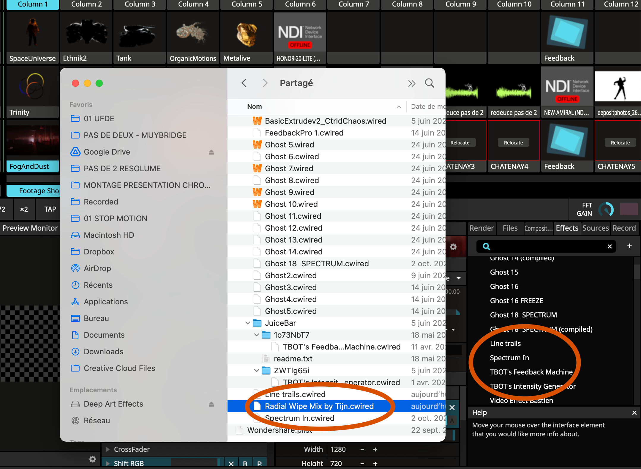

Actually, I can't use this patch. As it's shown in the attached screen capture the patch is well copied in the Patch folder but I can't find it in the Wire effect. Maybe is that because I work on Avenue, not Arena (but I'm not sure). Maybe would you agree to share the editable Wire Patch? I have a Wire licence.

Hi, if you installed it, you can find the plug-in in the blend mode section not the effect section....
let me know if it works....

Here's a small little tutorial. Hope this helps you out. If you have any more questions, just let me know.

Thanks a lot for this sharing. I'm very glad, this works well !
Yes, that's a great job.
