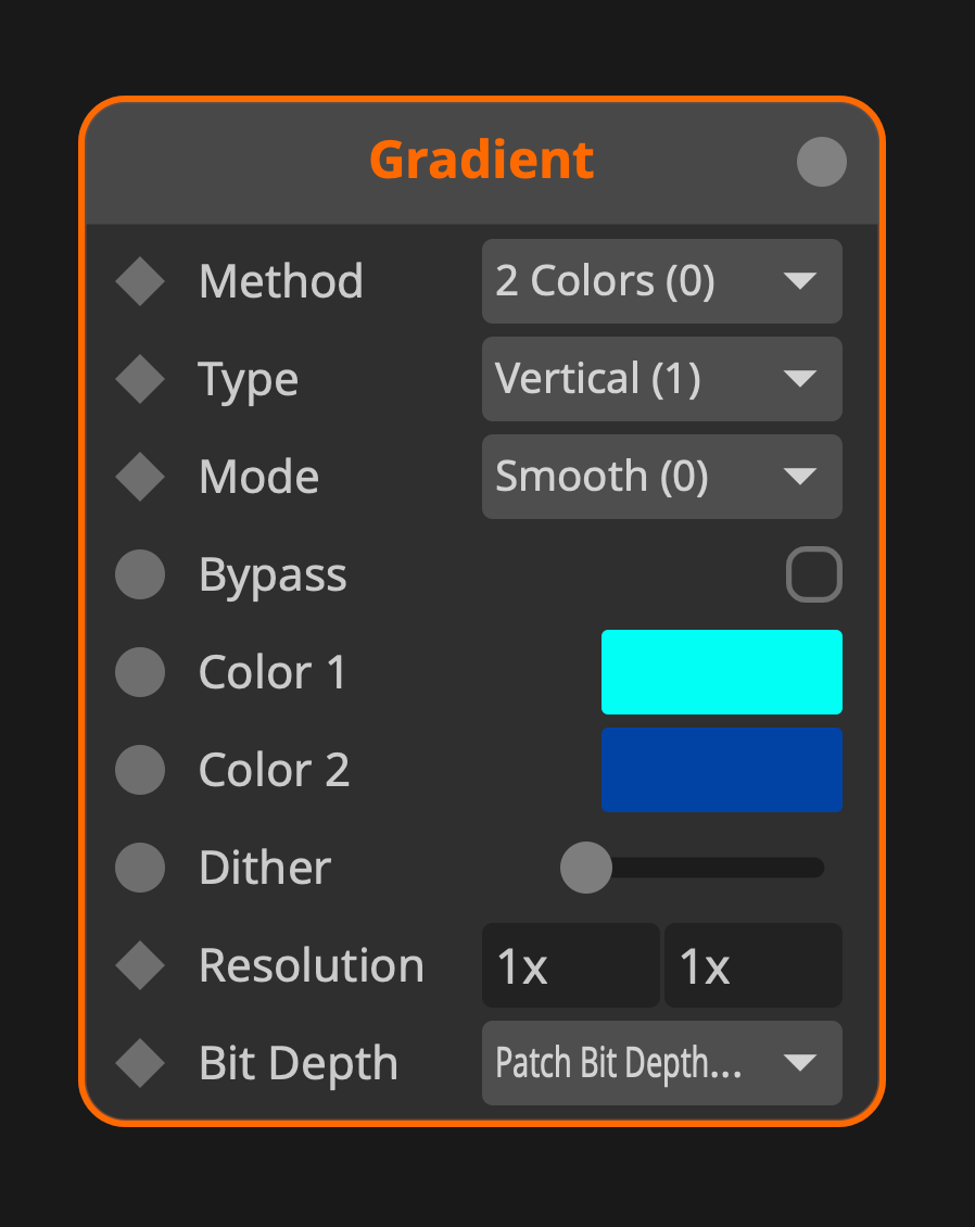

Hi, you can do this already. Just select the gradient node and right Click on it. And under visibility select type . Here you can also make more inputs visible. There are quite a few nodes that have more outputs or inputs, then the ones that you see at first. So trying to right click on a node and seeing what else is there, is always a good tip.

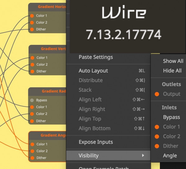

@tijnisfijn, thx for reply. I'm a frequent Wire user and already familiar with the option to expose or hide specific inlets (a nice feature I use often). I'm using an older Wire version 7.13.2.17774, and at least on that version, as far as I can tell, the Type inlet is not exposable, see screenshot.
Method and Mode are, at least in that version, also apparently not exposable.

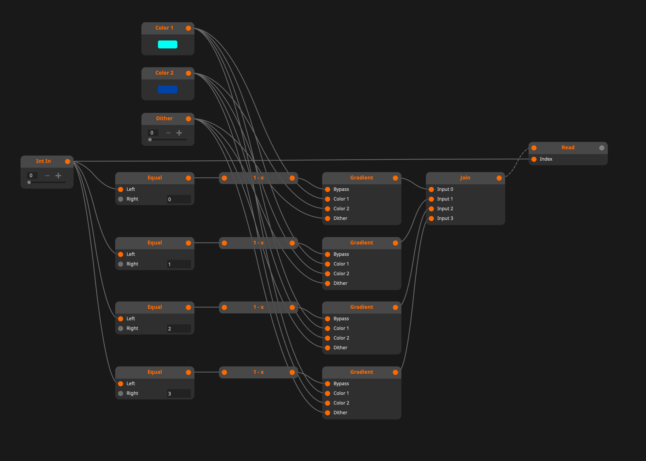

As you can see from the screenshot, I'm am currently using a workaround, using Choice In and Switch (not shown) to choose between 4 Gradient node variants, which may incur a performance hit (haven't tested to compare).

OK then this is probably the workaround that you should take or maybe consider doing a update because in the newer versions it is possible....
on tip i can give you is bypass the 3 gradients that you're not using that helps you save same frames.
