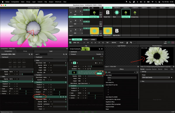

So as i want to go now deeper in converting.

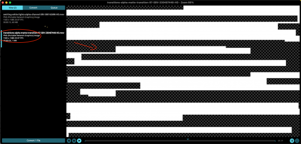

about to include alpha channel or not:
what is the reason to turn on or off alpha channel in converting.
I always thought resolume can generate an alpha channel out of any "white" contained in any clip i put in a layer or the alpha channel always have to pregenerated in converting in alley before?
So the simple rule would be to convert "with alpha" only for black and white / greyscale content ?
or whats the benefit or disadvantage to have it turned on or of for any video file you convert?

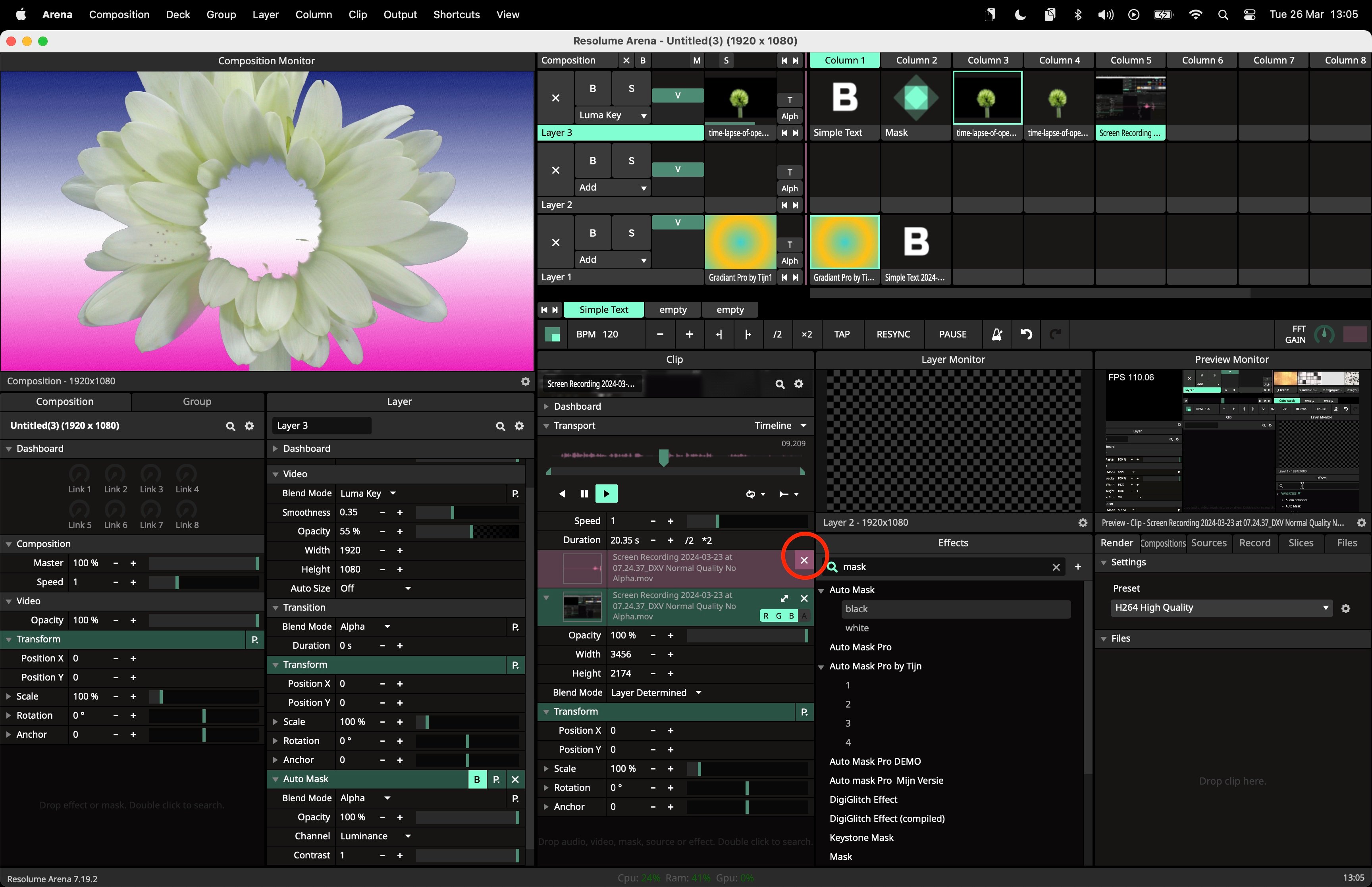

Hi again, to give you some insights ....

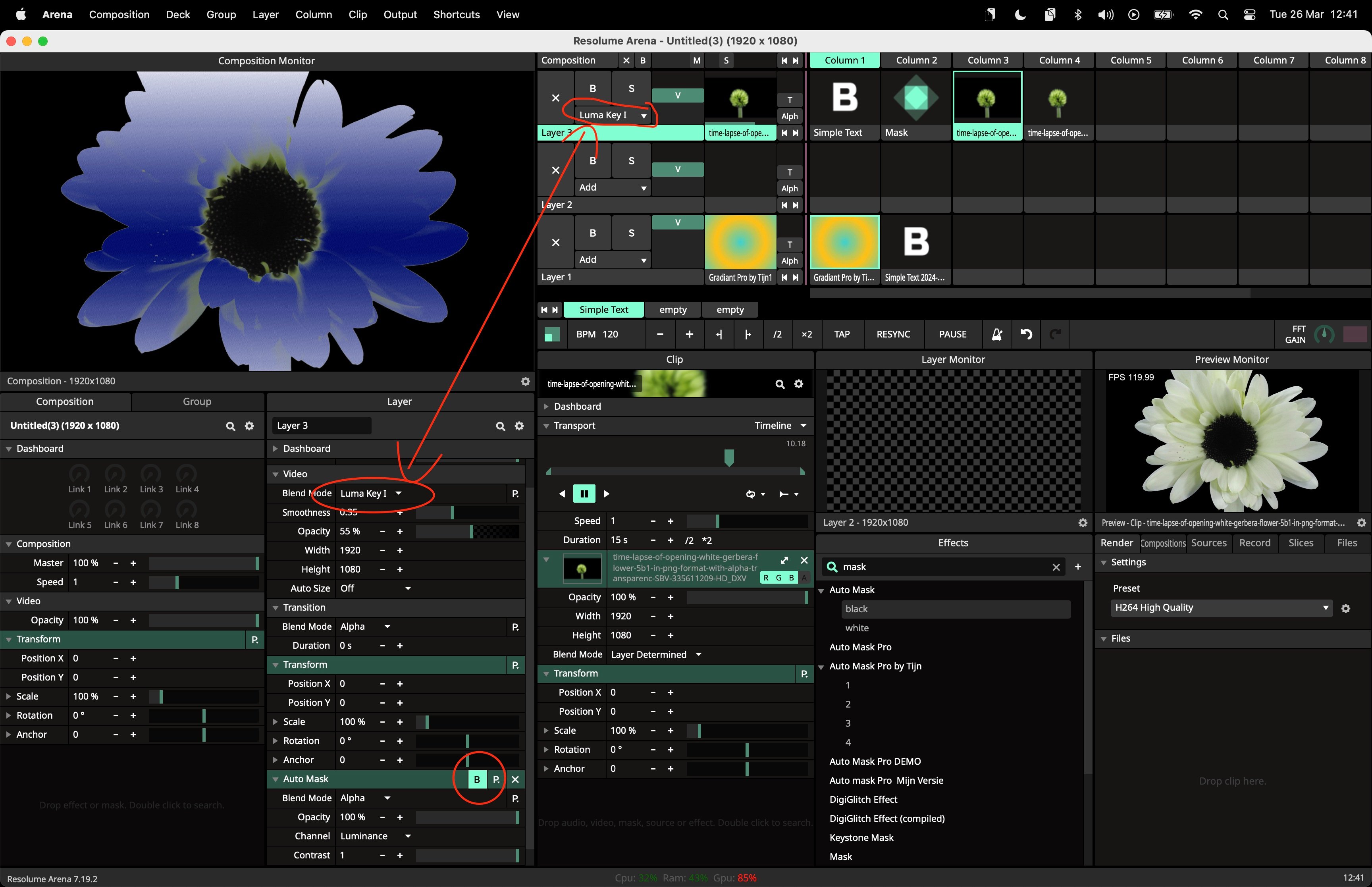

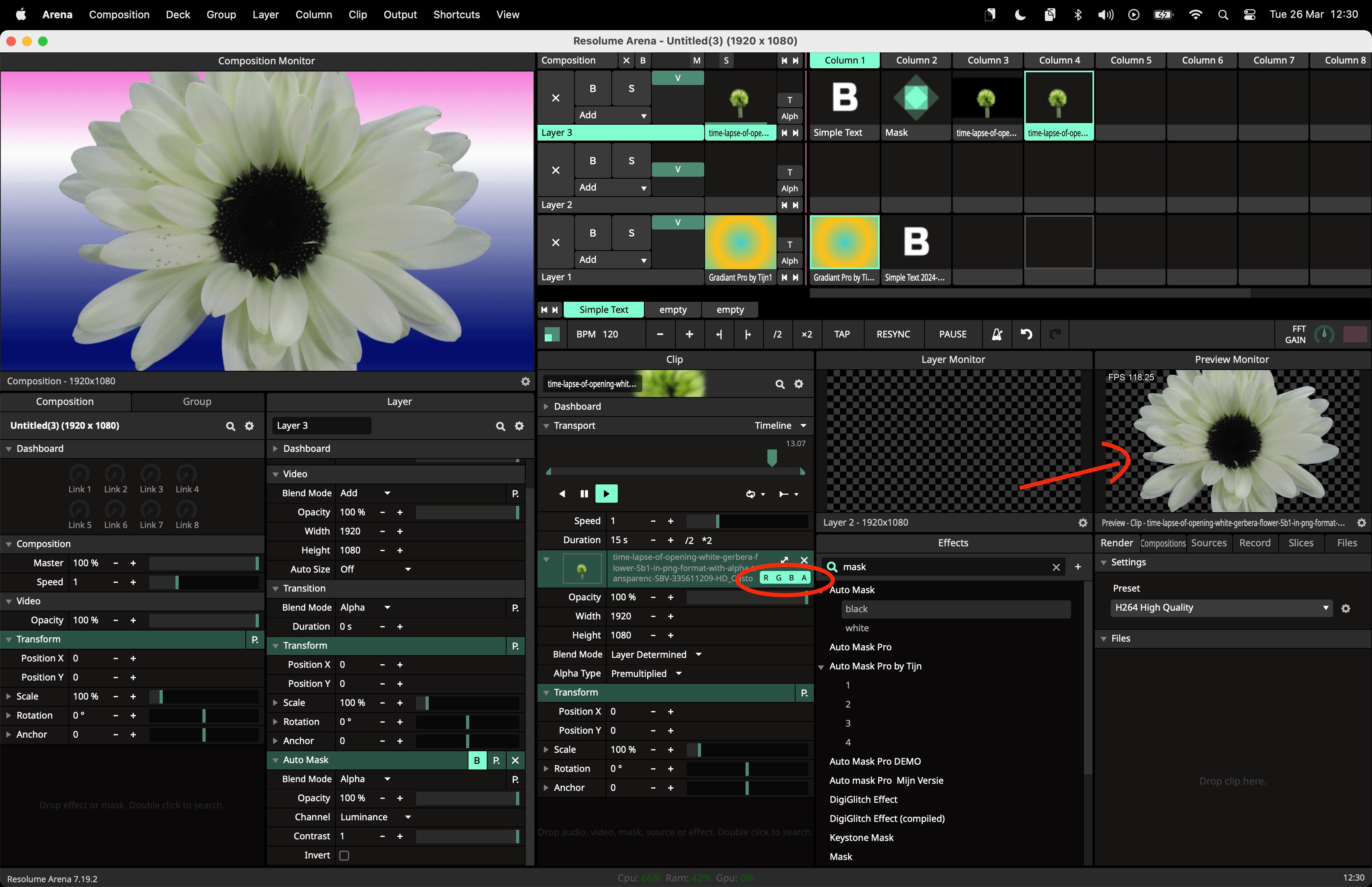

- An alpha channel can only be rendered (in Alley) if the original movie had a alpha channel in there. This can be really easy/handy, see this as a built-in mask. You could also use effect like auto mask to mask out all the black or white, but this way you also cut out really dark gray's for instance, if you want to mask black. See the first two pictures... Here the original movie had a alpha channel. And one is rendered with a alpha channel and the other one without.
- if your movie doesn't have a Alpha channel, you could also use a blend mode like Luma key to cut out the black or white. But like you see in the pictures, it will still take out the middle of the flower, that would never happen if this movie had a alpha channel.

Re: Resolume Alley - Noob Questions
Well. First of all Thank you for you detailled answer.
i collected some follow up questions:
1. where is a typical place to buy videos containing alpha channels?
2. why i can select and deselect it in the Convertion. or why Alley is not able to tell me that the file i want to convert contains already an alpha channel.
3. what happens if i select to contain alpha on a video that doesnt have it? do i get a different output filesize or the result is identical selected or deselected when the original source dont have an alpha channel.
3. what about when i create PNGs. i just can export as "white" and it will work as alpha or i should export an PNGs white as a "transparent" path.

he good to hear that helped...
Here are the answers to your other questions I got a little overboard and this is definitely the longest post I've ever made. I let my assistant, chatGPT, help a bit with writing to save some time
1- There is not one straight answer for this. There are so many places where you can get videos, sometimes with, and sometimes without Alpha channels. Here's a list i found but there are many many more... https://bjosephburch.com/royalty-free-s ... o-footage/
2- Alley will show the original compression and it will show a transparent background in the preview. Those are the two ways to see if you're video has a alpha channel and the options are just always there. Pick it if you need it
3- You will most likely get a larger file size and an identical video output (with a black background) when recompressing a video to contain alpha if the original source doesn't have an alpha channel. Here's why:
Alpha channel explained: An alpha channel stores transparency information for each pixel in an image or video frame. Videos without an alpha channel inherently have an opaque background (usually black).
Recompression with alpha: When you force the recompression to include an alpha channel, the software doesn't magically create transparency data. Instead, it creates a new alpha channel filled with a default value, typically representing full opacity (black).
Identical video output: Since the original video lacks transparency information, the recompressed video with the new alpha channel will visually appear identical to the original. You won't see any transparency effects.
Larger file size: The addition of the alpha channel, even if filled with black data, increases the overall file size compared to the original video without alpha.
In essence, you're adding extra data (the black alpha channel) that doesn't affect the visuals but increases the file size.

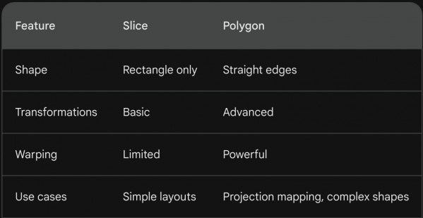

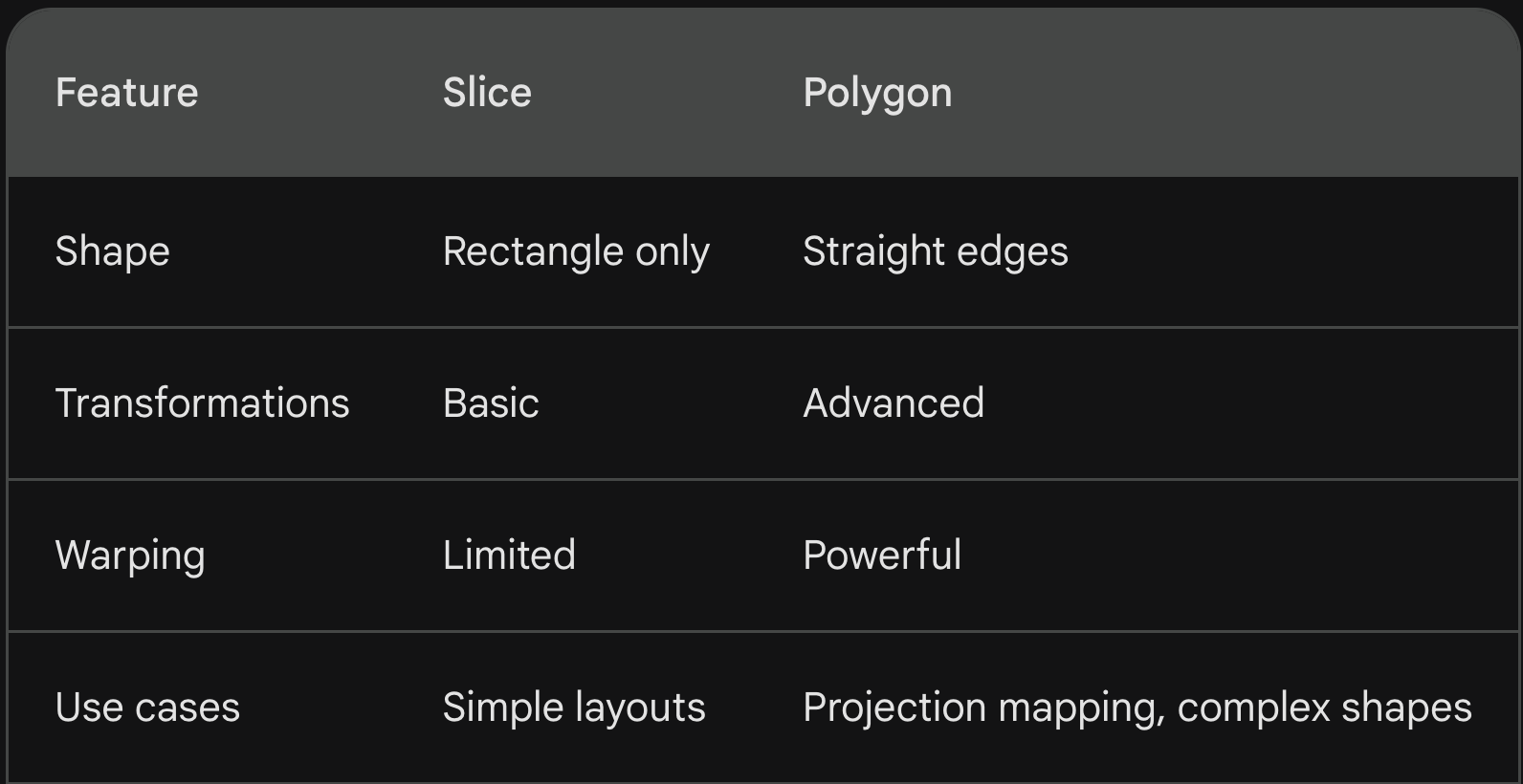

4- In Resolume Arena's Advanced Output, while both slices and polygons define specific areas of your clip to be shown on the final output, they differ in their functionality and capabilities. Outside of Arena's Advanced Output they behave the same and they are both treated like slices:
Slice:
Function: Defines a rectangular region of your clip.
Shape: Always a rectangle.
Transformations: Offers basic transformations like scaling, rotation, and positioning within the output.
Warping: Limited warping capabilities, primarily for basic corrections.
Edge Blending: Can be used with edge blending for smooth transitions between adjacent slices.
Use cases: Simple selection and positioning of content, often used for basic layouts or tiled visuals.
Polygon:
Function: Defines a custom shape with straight edges that determines the visible area of your clip.
Shape: Created by connecting multiple points to form a closed shape.
Transformations: Offers advanced transformations, including scaling, rotation, positioning, skewing, and perspective adjustments.
Warping: Powerful warping capabilities for precise manipulation and fitting onto complex surfaces in projection mapping scenarios.
Edge Blending: Can be used with edge blending for smooth transitions between adjacent polygons.
Use cases: Ideal for projection mapping onto non-rectangular surfaces, creating irregular shapes with precise control, and achieving more complex distortions and effects.
Here's a table summarizing the key differences: Choosing the right tool:
If you need a simple rectangular selection with basic transformations, use slices.
If you're working with non-rectangular projection surfaces, require precise control over shape and warping, or want to achieve complex distortions, use polygons.
Additional points to consider:
Slices are generally considered easier and faster to set up, while polygons offer more flexibility for intricate adjustments.
Depending on the complexity of your project, you might combine slices and polygons for different areas of the output.

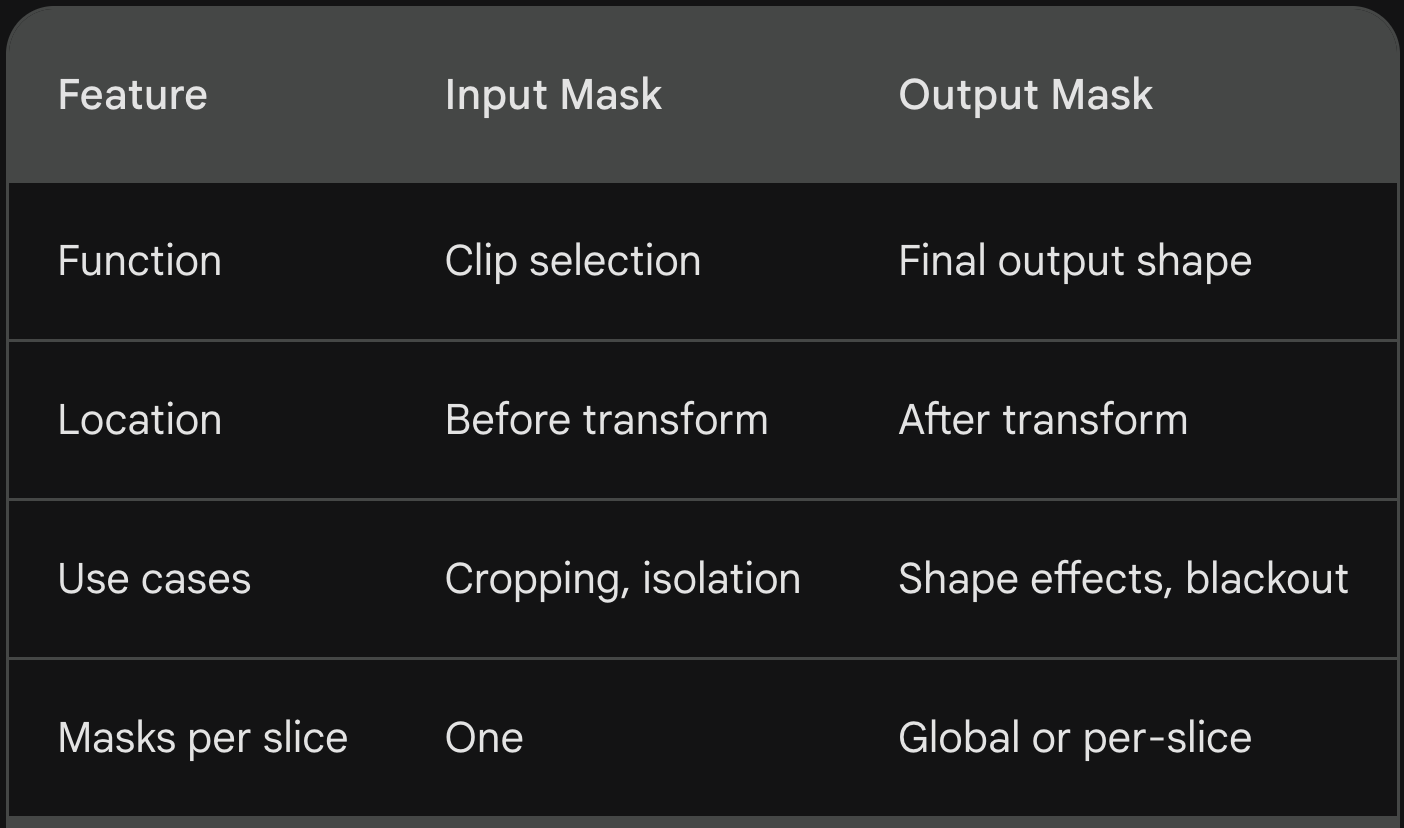

Masks:
There are two different types of masks you can use in Resolume Arena's advanced output: Input Mask and Output Mask. They serve distinct purposes in defining what gets shown on your final output:
Input Mask:
Function: Defines which part of your clip gets sent to a specific slice.
Location: Applied before the clip is transformed and positioned within the output.
Use cases:
Cropping unwanted parts of the clip before it reaches the output.
Isolating specific elements within the clip for individual manipulation in slices.
Creating interesting effects by masking out certain areas of the clip.
Limitations: There can only be one input mask per slice.
Output Mask:
Function: Defines the final visible area of the slice on the output.
Location: Applied after the clip has been transformed and positioned within the output.
Use cases:
Masking specific shapes onto the final output (e.g., revealing content through a cutout shape).
Creating blackout zones on the projection surface.
Combining multiple slices with different output masks for complex visuals.
Global vs. Per-Slice: Resolume Arena offers a single global output mask that affects all slices or the option to create individual output masks for each slice.
Here's a table summarizing the key differences: Choosing the right mask:
- Use input masks when you want to control what content gets sent to a specific slice from the original clip.
- Use output masks when you want to define the final visible area of the slice on the output after transformations.
5- There isn't a single, comprehensive official Resolume manual in the traditional sense. However, there are excellent resources available to help you deep dive into learning Resolume, especially considering your background in lighting design. Here are some options:
Masks:
Input Mask:
Use cases:
Output Mask:
Use cases:
