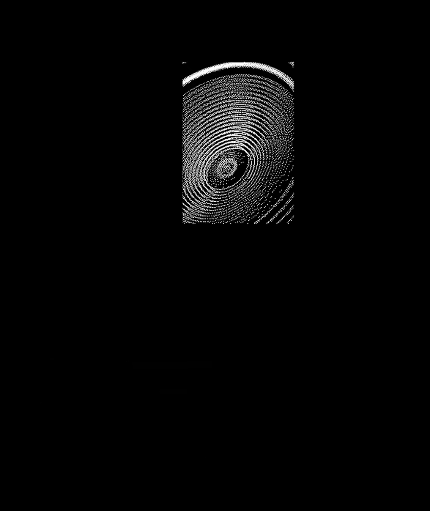

So I have discovered the technique is called 'Stipple' , and one way to achieve this is to use the Mode -> Bitmap (Dither) feature in Photoshop. I haven't figured out how I might pull this off in real-time in Resolume yet. I fear it might be quite GPU intensive.

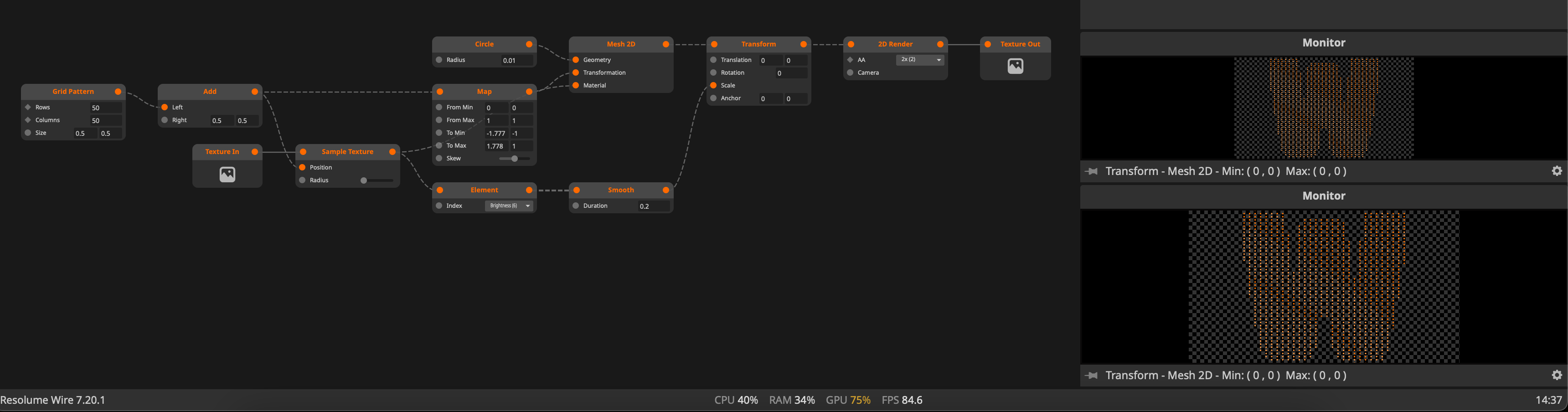

Since 7.20 we allow reading back pixels to the cpu to be able to perform calculations based on pixel values.
This allows quite some nice tricks as you can see in the new Strokes effect.
I attached a patch which samples the colors and uses the luminance to scale the meshes being drawn. You can easily expand/change it to get a more low tech look. Adding some noise to the grid would work quite well.
