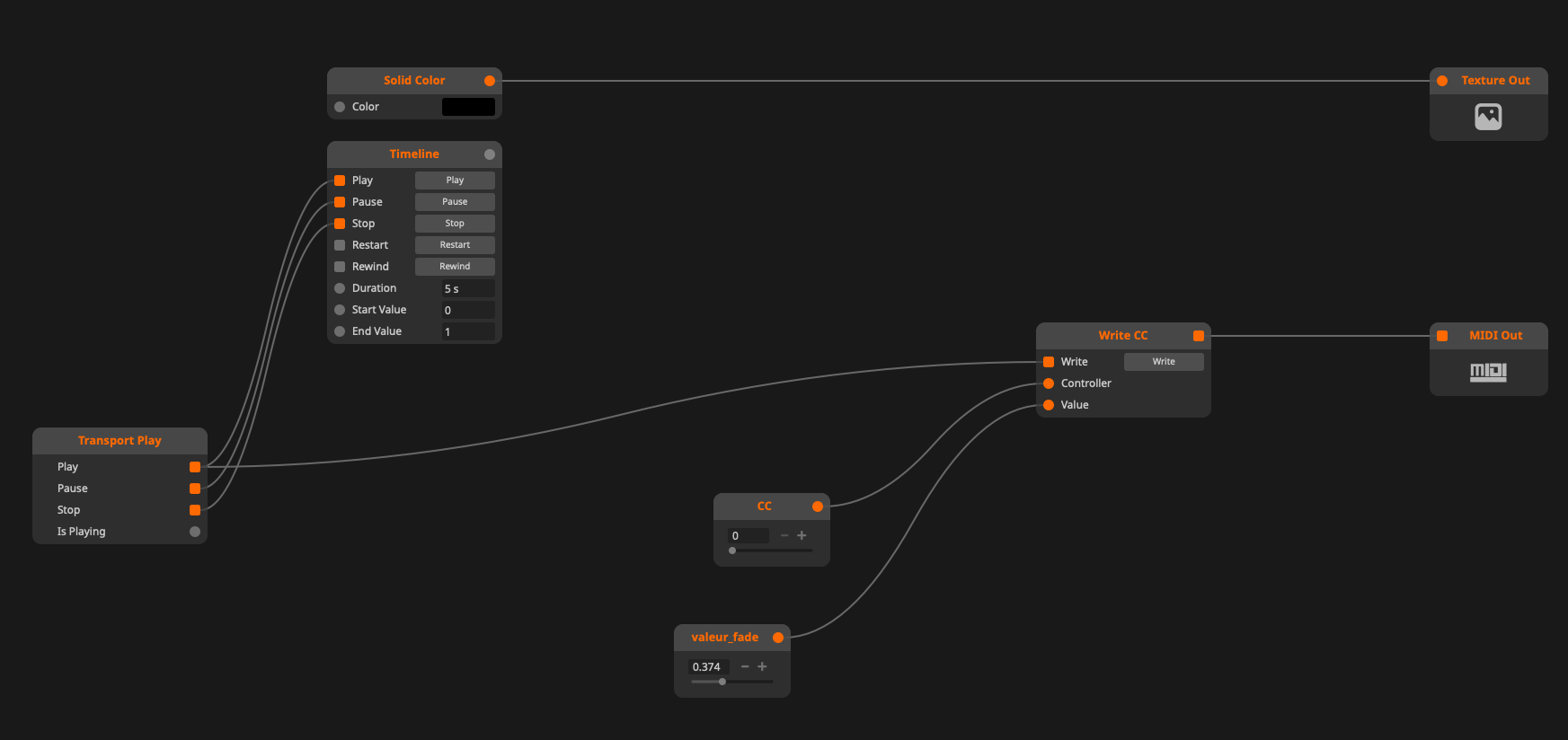

Hi everybody,
I'm searching a way to create a midi patch to send Midi CC when a clip is trigged.
I realize one like this with osc to trigger Madmapper Cues (work perfectly).
I create a IAC midi driver.
I can send midi CC but I can't receive it.
If someone have an idea. this is to automate transition duration changes

Do you want to receive the CC in Resolume or your patch?
Have you tried the midi shortcuts yet?
https://resolume.com/support/en/midi-shortcuts

Thanks for your answer,
I want send midi CC in own Arena when I trigg a column.
It's for that i want to create a wire patch like i do send OSC message to MadMapper for exemple.

Re: MIDI loopback
Alright, the https://resolume.com/support/en/midi-shortcuts should work for that.
Create a loopback Midi interface in the system, then enable it in the Resolume preferences as output.
You can then create note shortcuts on the columns using the right click menu in the shortcut editing mode.
