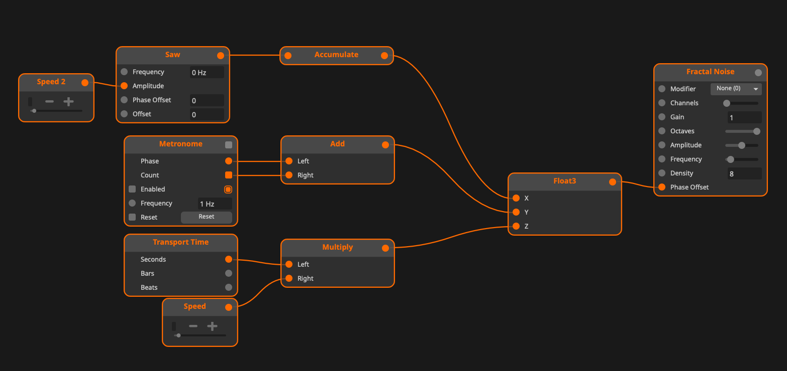

i want to create a simple looping fractal noise as displacement map in wire.
In After effects or C4D you can set the evolution loop option. is there something similar?
thanks in advance

You mean something that keeps counting up right? there are several different ways of accomplishing this in wire. In this example I gave you a few, but there are many more.... anything that can count you could use.
Hope this helps you out..
Oh, don't forget to press play on the top bar in wire.
