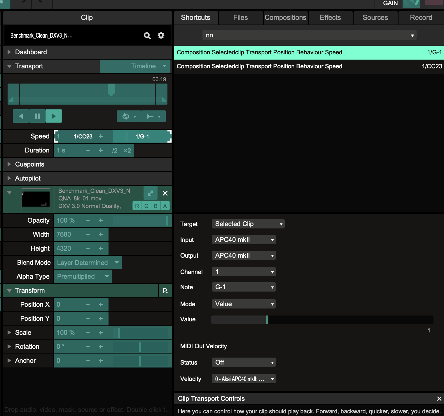

1- is already possible, underneath clip speed there is duration, right from that there are /2 and *2 buttons you can map.

You could set up a note /button to set the value back to 1

The "Duration" label is a bit misleading I assumed this would move the out point of the clip but I see the intention but could be under the same same dropdown as speed.
Having a separate cc button that returns the clip to 1 takes up valuable space on midi pad and doubles programming for every clip....
The 2. option described is for a CC dial (I was looking to have a dial for each layer). If you imagine the 300 Degree range (on an Akai APC) if the X value=5 this would split this 300 degree range into five sections of 60degrees of dialing. If we assume for arguments sake the APC cc dial starts at 0 degrees then 150 derees is pointing up and 30 degrees of that either side would still be the "Speed=1" range. The multiplication factor is applied to each 60 degree range after this. Then you can BANG something right up and find a happy balance between your X factor and multiplication Y factor to get speed and back to 1 safely.
