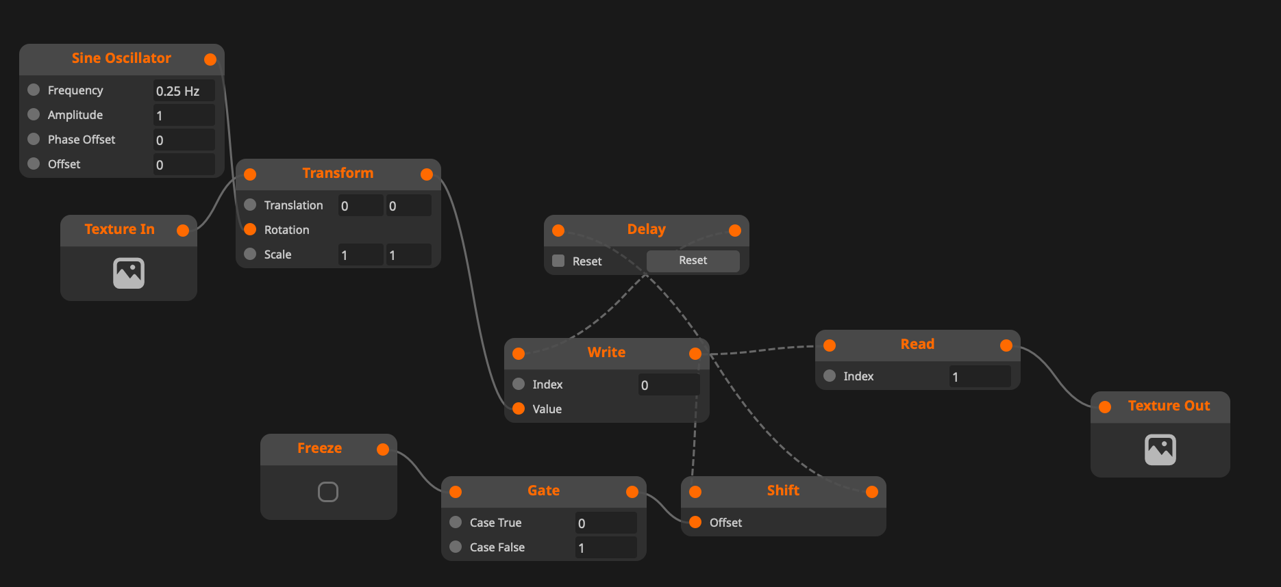

You can build a custom texture buffer using Write with feedback.
Then eithere shift the buffer or change which slot you write to, chaning the instance count of the delay node defines the buffer size.

Thank you, I'll look into it to see how can i incorporate it into my effect.
