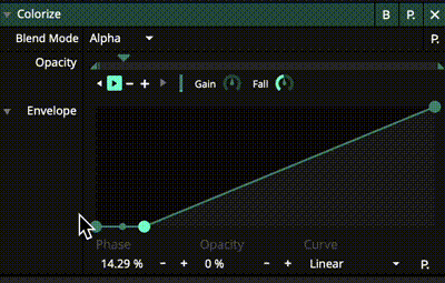

If you put a envelope on the parameter you want to control and keep the first part on 0. You essentially build a threshold where the sound has to go over before it triggers something.
As you can see in the gift, this little audio signal does not trigger anything now I hope this is what you're after good luck, and if you have more questions, don't hesitate to ask

Thank you for the advice!
