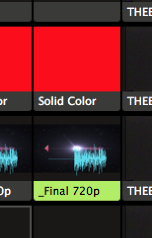

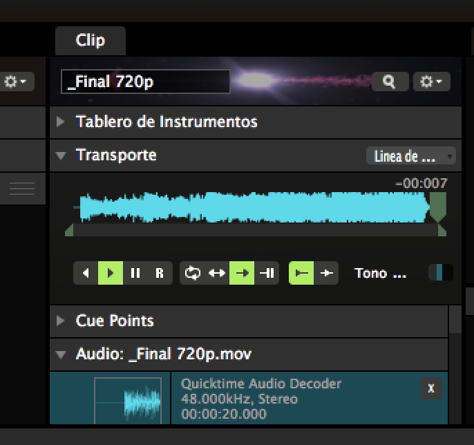

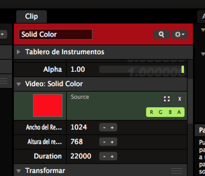

Ok tested and I have to add two seconds to the length of the solid to jump at once to the next column. I understand nothing.

I'm sure. I timed and these are the results:
Video: Audio Duration 00: 20: 000 Timed to jump to the next column: 00:20:00
Solid or image: set to 20000 milliseconds actual duration to jump to the next column 00:19 seconds.
I think the problem is in the duration set in milliseconds since they are not correct.

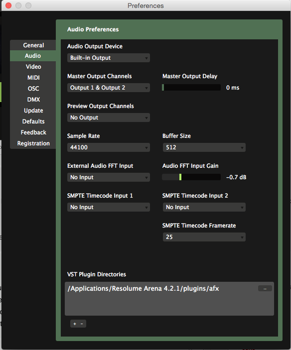

Re: Auto Pilot Problem
Okay, can you post a screenshot of your audio preferences tab?
