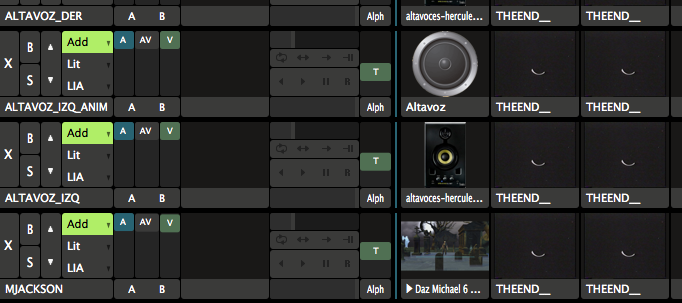

Please I need help. I have several layers with activated auto pilot, they contain video and images in the same column, when all active column to run all the videos and images containing not end all at once to jump to the next column. my videos last 2:25 and establish the duration of the images to 145000 milliseconds but not end all at once and launch clips in the next column at different times.

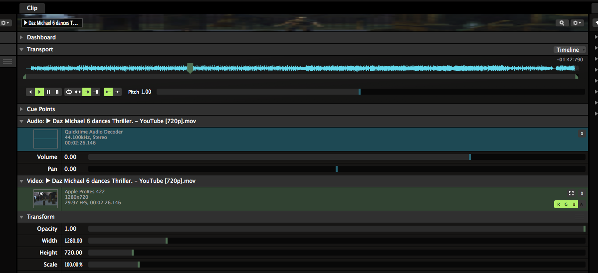

I use the video has audio, the video is set to play in timeline mode, image attached.

and which timing is correct if you measure with stopwatch?
I don't use prores codec, others may know if it could cause this kind of problem.
by the way, that clip is 2:26, not 2:25!
set your still image duration to 146146 ms
