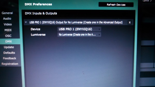

The PC connection is not working now, either. I had everything up and running, then went to switch the Enttec devices on the PC, hoping to get the both working via PC as I have another PC avail to run Arena, and when I connected the original working Enttec to the PC I received this promt. I'm not sure why its asking for an Output Lumiverse suddenly. This all occurred within 10 minutes.
The PC sees both Enttec devices this way. Both devices firmware is up to date.
Re: Enttec Mk2 on MAC not connecting
You've created a DMX output, not an input.I'm not sure why its asking for an Output Lumiverse suddenly.
Yes. You're Enttec boxes are working fine. It's the drivers on the Mac that are causing the problems. You really, really, *really* need to contact Enttec support and ask them to help you get rid of the d2xx drivers.The PC sees both Enttec devices this way. Both devices firmware is up to date.
