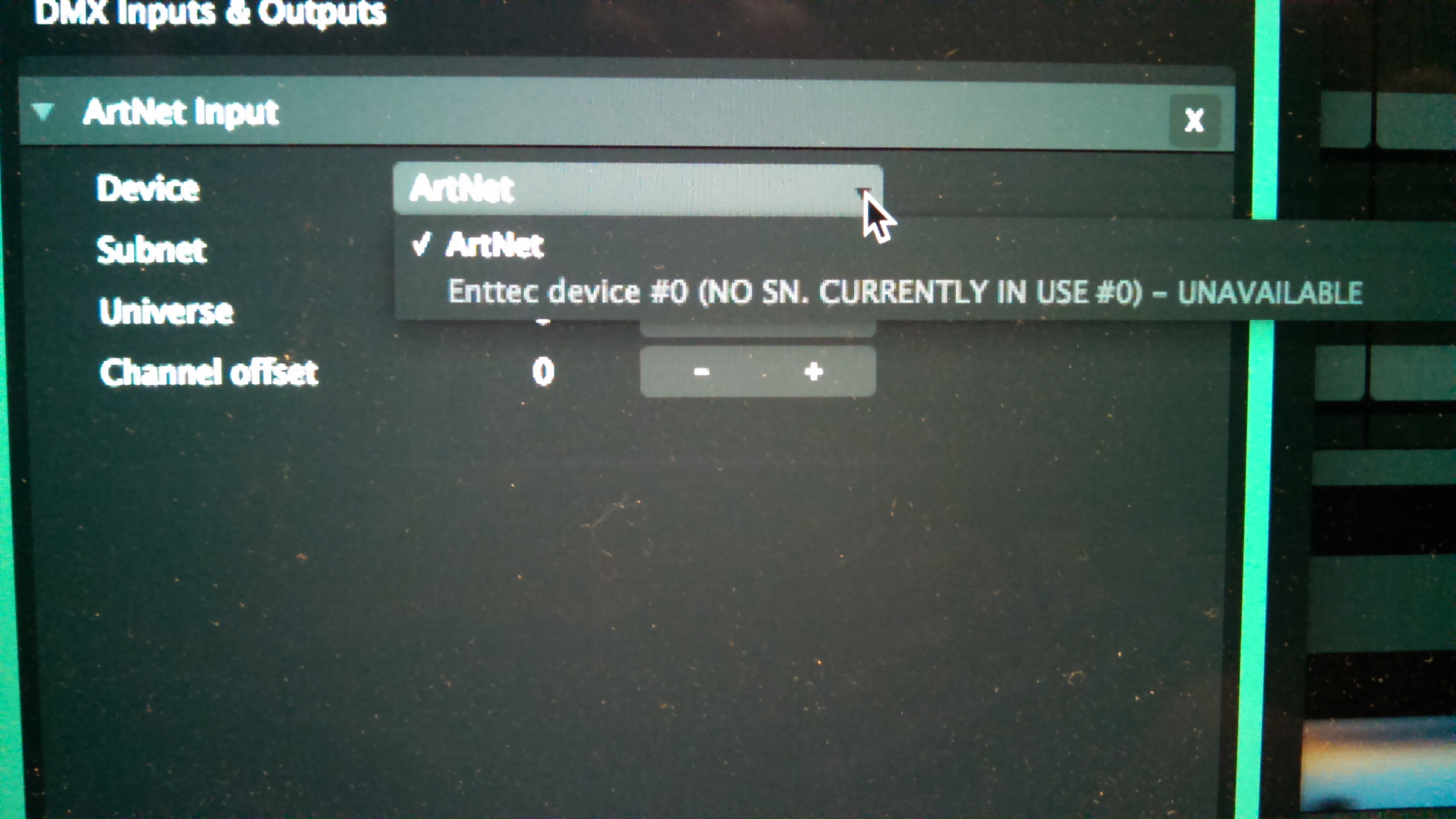

You'll have to uninstall all the drivers you've installed.
Also, you're selecting DMX input so arena won't output anything. To output DMX, you'll have to create an output and assign a Lumiverse.

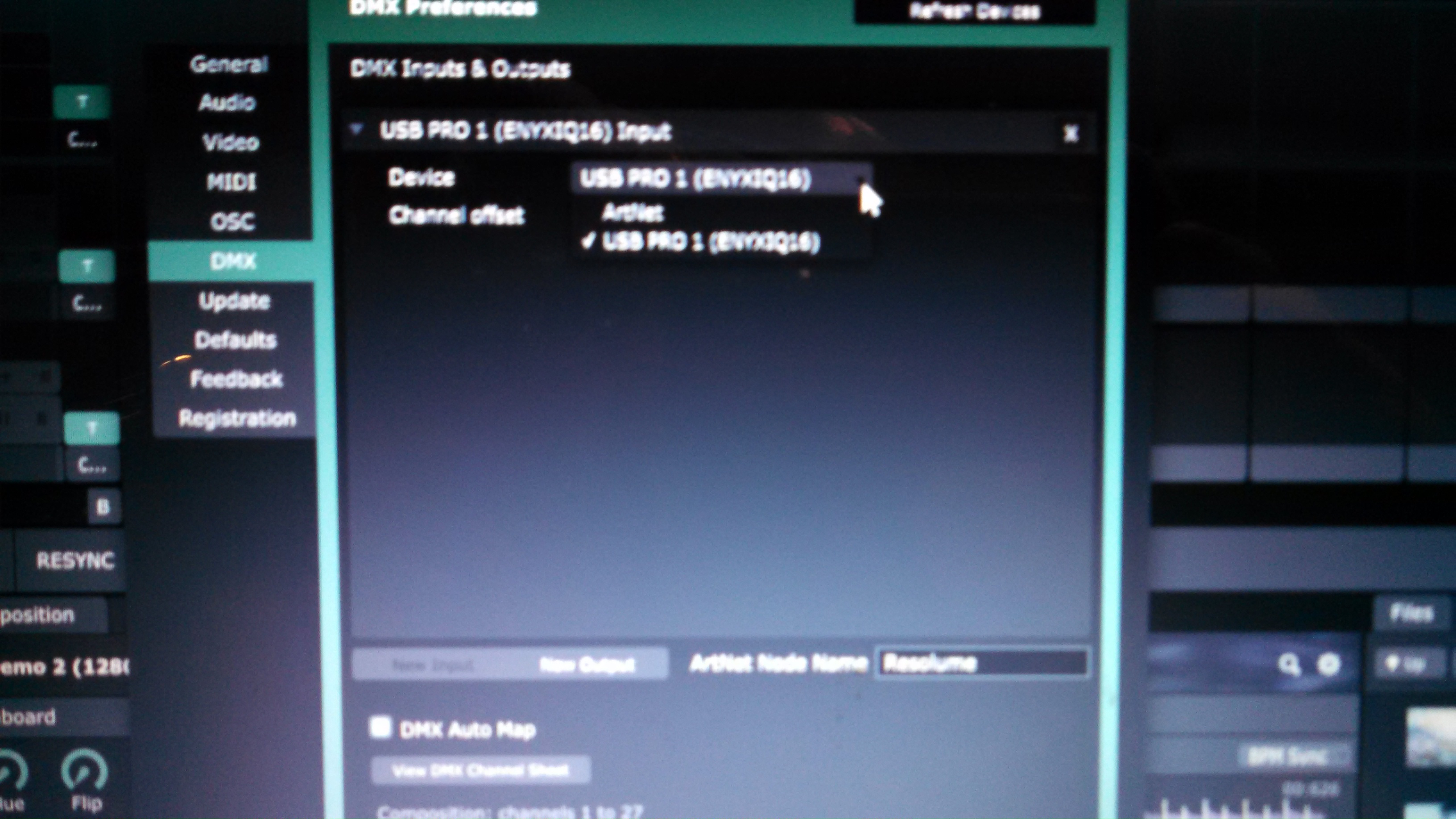

Yes, I corrected it to output, still won't see the Mk2. The PC connection is fine. I don't have a Lumiverse created for the PC.
The Link effect is Strobe.
This pic is with the PC connection. Same hardware, same composition, only difference is the mac book.

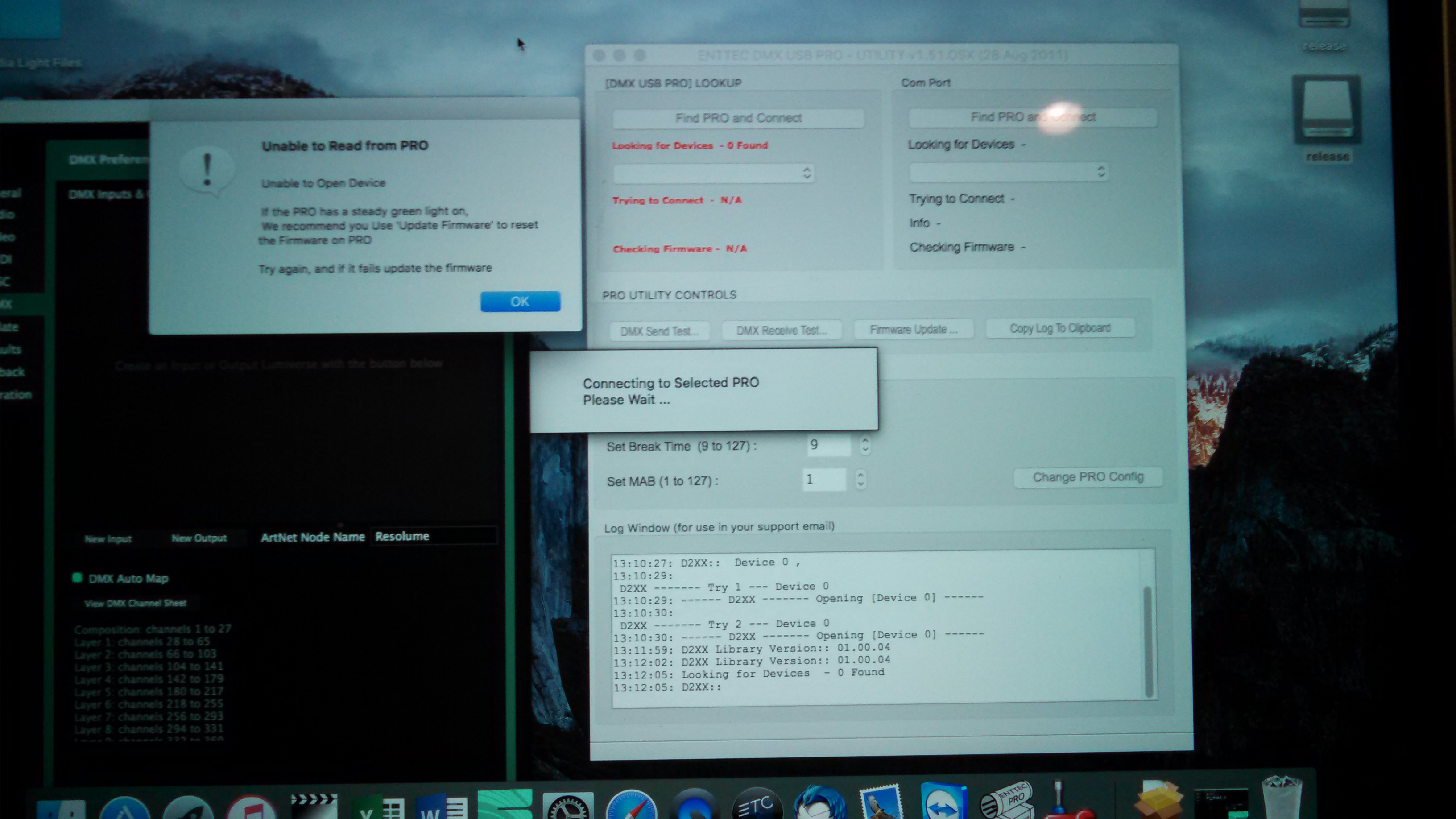

This is the result from the pro utility.
Re: Enttec Mk2 on MAC not connecting
If you want to use DMX to control Resolume, there is no need to create a Lumiverse, those are only needed to patch fixtures for DMX output.
If you are also having trouble connecting to your Enttec box using Pro Manager, I would first contact Enttec support. They know more about their hardware than we do :)
