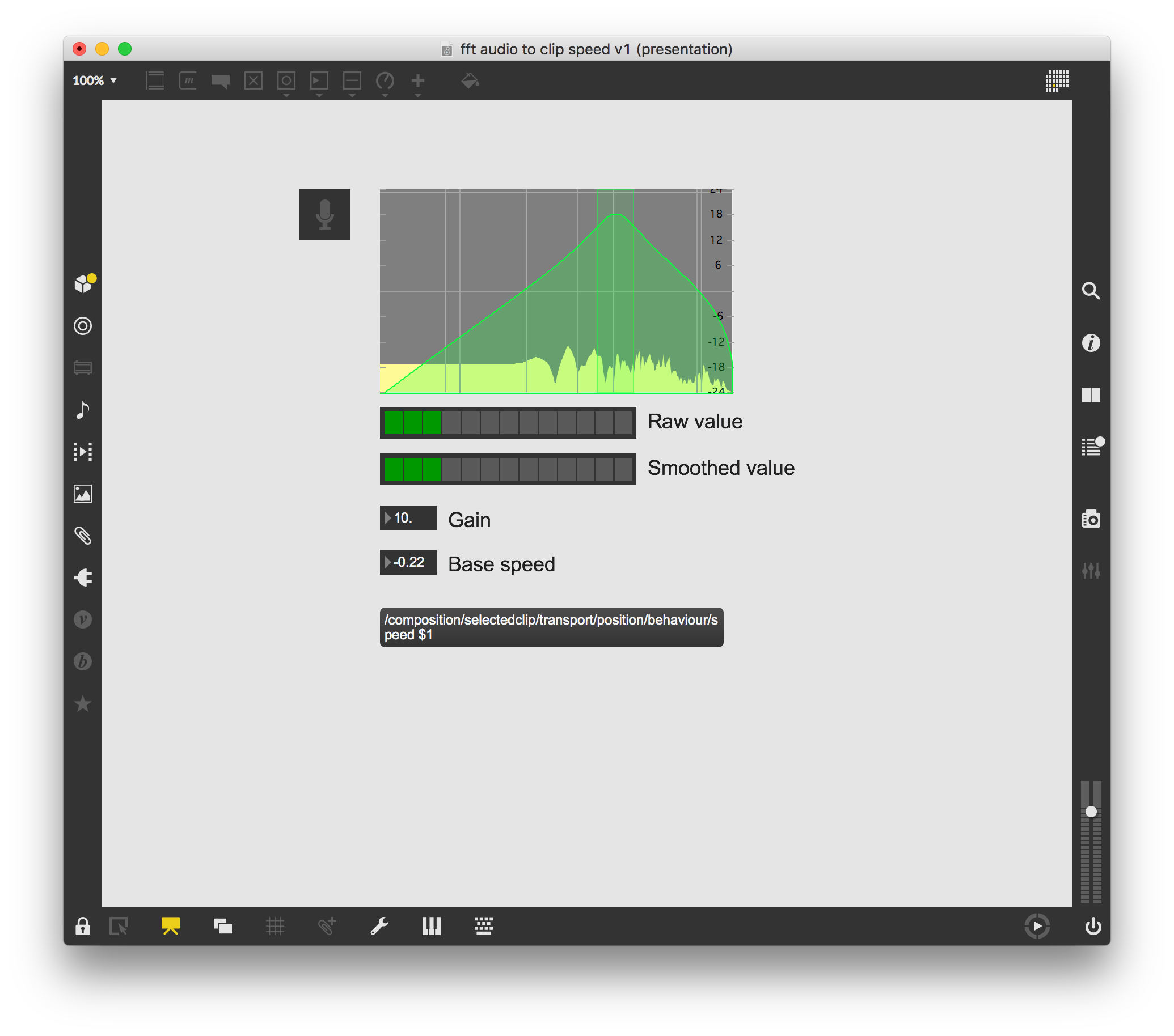

I've made a simple Max patch that does this, and controls the playback speed in Resolume. If there is any interest I can clean up and make it a little more finished. I hope it may serve as a proof of concept for whatever the Resolume team comes up with.

Here's how it works:
Things to add:
Here is an awesome video: https://youtu.be/ntY_OcWI7PE
- Set the patch to presentation mode, if it isn't already
- Press the microphone button to start audio in
- In the audio spectrum, watch what happens when you make some noise, and put the sample band where you want it
- Check the VU meters to see if it is responding
- Adjust the gain and base speed values to whatever you want
Things to add:
- Editable OSC configuration as per my other patches
- Poll Resolume for the current playback speed, and use that as the base speed
- Make the OSC string editable (or supply a list of presets)
- Add multiple FFTs so you can have multiple parameters responding to different frequency bands
- Add transient detection (eg drum hits) and use that to trigger clips

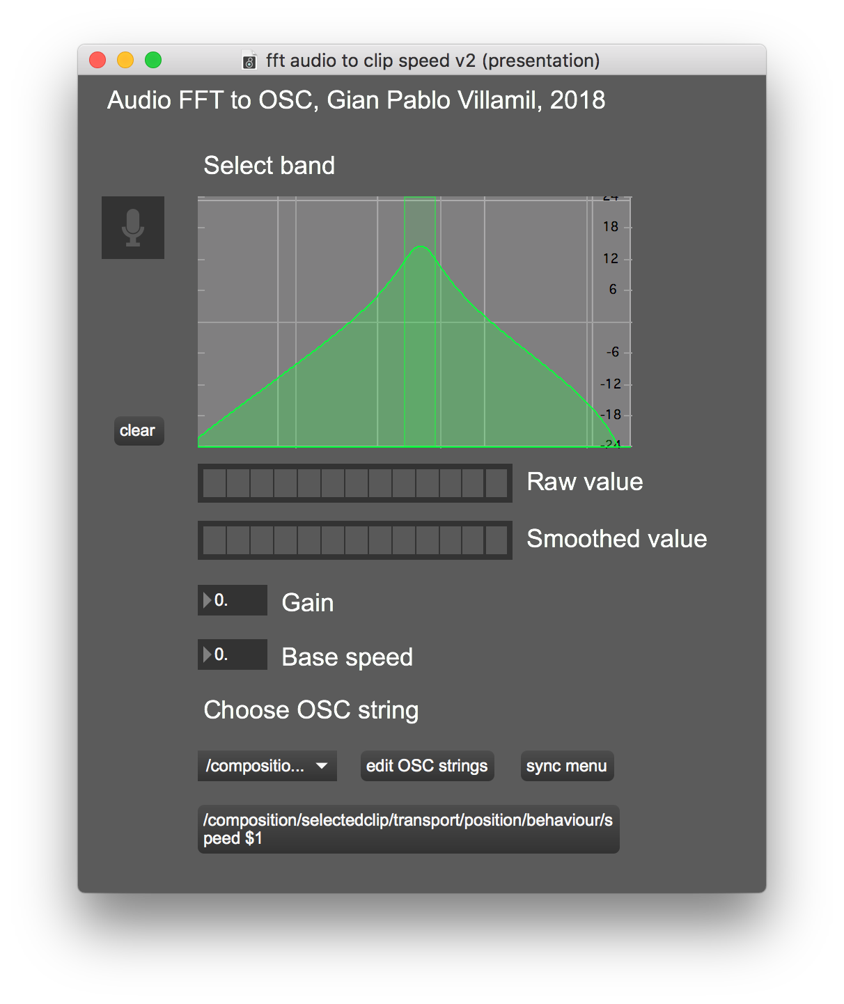

I've updated the patch to version 2. It's attached to this post.
As with the previous version, you need to provide a value for base & gain.
If you are animating speed, base = 1 and gain = 10 will play the clip at its regular speed, but speed up when there is audio. If you are animating position, base = 0 and gain = 1 will animate the clip over its timeline from beginning to end.
Now you can edit the OSC strings that are sent to Resolume. I've currently added two, you can animate either speed or position. Feel free to add more. Maybe you can add the layer/clip # for a specific clip. The value sent from the FFT replaces the $1 placeholder.
Click "Edit OSC Strings" to open the edit box. When you're done, press "Sync Menu" to update the popup menu. Choose a string from the menu.
The "Clear" button hanging out to the left of the graph resets the filter object, just press it if things are weird.
