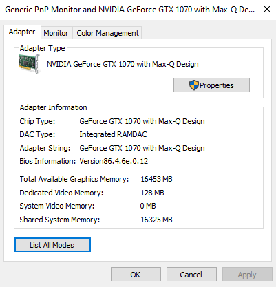

this doesnt look right does it? its an 8gb card. is memory leaking?
1070 Max Q
1070 Max Q
Screenshot (17).png (21.37 KiB) Viewed 7420 times
