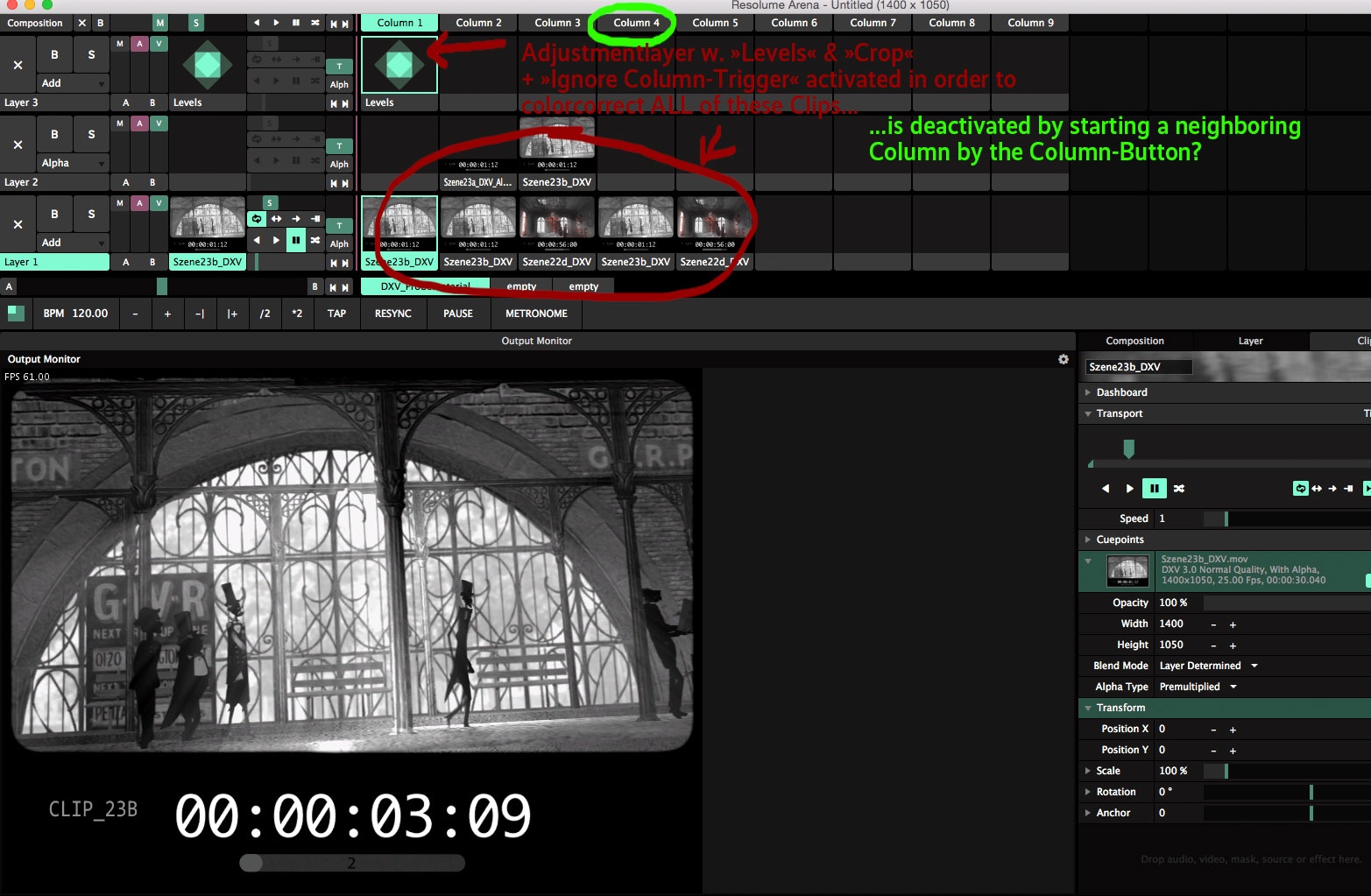

When I activate the »Ignore Column Trigger« functionality on the Adjustmentlayer (with the Levels-Plugin and Cropeffect in it) - why is this Layer shutting up nevertheless, when I start a next Column via the Column-button (See picture)?
Everytime I think I got it, something is difficult at the end.

Try this, a simple fx clip with levels (I've added color to notice it in snapshot) with a simple jpg mask.
Then enable the Layer 'ignore column trigger', not in the clip itself.
