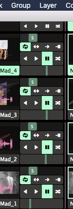

So now, I am on Version 6 to try and SCRUB the transport to a cue point, but unless there is a menu/preferences to LOCK ALL CLIP LAYERS to the FIRST LAYER, this is not working. Layers 2, 3, 4 do NOT follow Layer 1.
What am I doing wrong, or is it that this program WILL NOT do this at all? Why can't it be modified to add this feature? It is very simple to code that "LOCK IN STEP" and assign all layers to follow the transport/cue/scrub/time code of the 'master layer.'
As you see below (Version 6), I have slid LAYER 1 backwards to a different cue. Layers 2, 3 & 4 did not move from where the program was stopped. So hitting PLAY has them all out of sync now:
Screen Shot 2020-04-22 at 3.42.53 AM.png (34.99 KiB) Viewed 9643 times

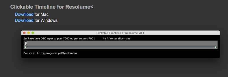

Edit: I just remembered I made this tool that could help http://palffyzoltan.hu/index.php?url=pr ... letimeline it does the same, scrubs 30 layers with a long slider.

I can't find your program "Multilayer Sync Scrub" ANYWHERE on your page that you link to. Did you rename it to: "CLICKABLE TIMELINE FOR RESOLUME?" – Is this the same as "Multilayer Sync Scrub?"
The next question is see my previous Post in reply to you. I entered a dummy number "0" zero for the VAT, which does not apply to me because there was NO WAY to get out of an endless loop if I didn't check: "I am a business."
So frustrating! :(
I won't buy anything until you confirm that:
(a) Clickable Timeline for Resolume is the same as "Multilayer Sync Scrub" which you want me to use. I saw the YouTube video link you sent and that would help a lot – although I would still want the programmers to work on the feature request!
(b) To buy the program, am I going to have any issues with PayPal with a VAT number of "0" zero?
Thank you, I think.
