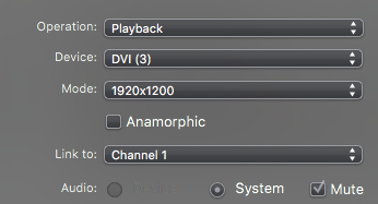

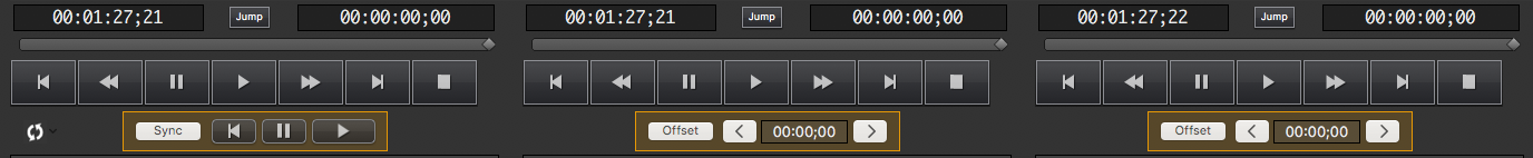

If you look at the attachment for a competing product, Pro Video Server (2 screen grabs), I can set the program up to "Link to Channel 1" and then scrub the timeline ANYWHERE or type in a TIME CODE, then hit ONE button: "SYNC" and all channels are within 1-frame of the lead Channel 1 - then hit PLAY. This can be done in less than 5 seconds!

- Preferences SET-UP Menu – All 3 channels set to follow Ch. 1 with the "LINK" selection.
- Screen Shot 2020-04-21 at 12.19.19 AM.png (26.93 KiB) Viewed 13516 times
- The 3 channels, with Ch. 1 as the "lead master" for Channels 2 and 3 to "follow." Sliding the timeline or entering a start timecode and pressing the "SYNC" button (only on Ch. 1 on the far left) cues all other channels, and pressing PLAY to the right of SYNC (in the yellow-border box) plays everything exactly in sync.

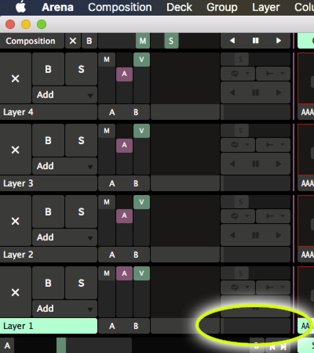

In the most-top window, the slide scrub bar (yellow circled in the attached pic).
I know you can enter numbers in the lower panel, but I have to do each layer one-by-one. Why can't someone write some code for me to enter the numbers like: 1;15;20;00 and hit enter and ALL layers/clips all sync to that, then I press "Play."

If the footages are the same length, I'd map the same keyboard key to the Layer position sliders (you highlighted above), and set the shortcuts to mouse mode. https://resolume.com/support/en/keyboar ... mouse-mode
Then when you hold the key, you can scrub all clips at once, together by moving the mouse.
Unfortunately there is an issue with scrubbing audio clips this way in version 7. We're working on that.
You can get around it kinda by pausing all clips with the composition direction controls, ejecting the clips then launching them again, and hitting play on the composition.
